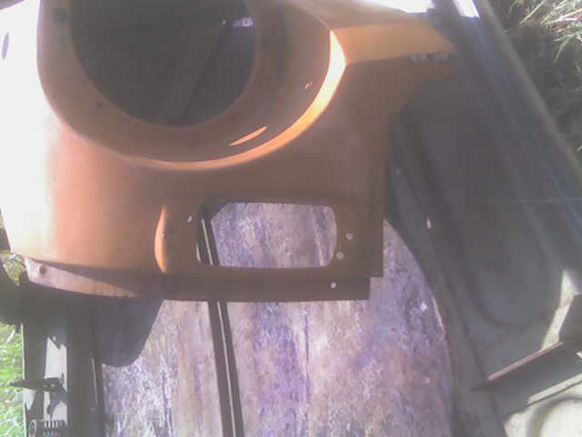

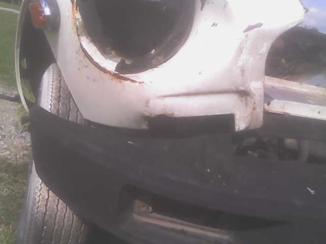

Attached is a picture of the RB GT fender at the front, and the floowing post will be the chrome bumper GT fender.
Im wondering if I cant just plasma cut the bottom of the turn sig mount to make it match the original RB GT fender.
Or are there different mounting points that I am not seeing to be different?

Hard to tell from those shots, Howard. It'd be a bit easier to tell if the bumper was removed from the car. However, it does appear at first glance like the potential replacement fender might work. The valence mounting might be slightly different between the two fenders, but it's difficult to say with the bumper in the way.
If you're planning to mod the turnd signal area to make it work, then the valence mount points shouldn't matter too much if they turn out to be different. The only concern then becomes whether or not the mount points under the hood are the same. The only way to know that for sure is to break out the tape measure.
Best of luck with the fender job!
chuck's correct..what I did to make a rubber bumper GT fender was take a rubber bumper roadster fender, cut the area where the windshield went through it off (from trim line to edge of hood opening)....then I took a chrome bumper GT fender & cut the rear piece of it that's different than a roadster fender (from trim line to edge of hood opening)...finally, I welded the chrome bumper GT fender piece onto the rubber bumper roadster fender & had a perfectly good rubber bumper GT fender......oh, before I would do any welding, I would bolt both pieces up to the GT body so everything is tacked together properly.
