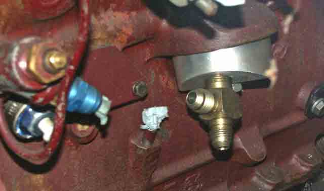

Pictured below is the fitting that replaces the banjo fitting on the oil exit, this is a reworked fitting that started life as a 3/8 NPT to 10AN, which was re thread to straight threads like the MG has, however there are diffenret ways yto do this you can aslo tap the block for tapered NPT fittings.

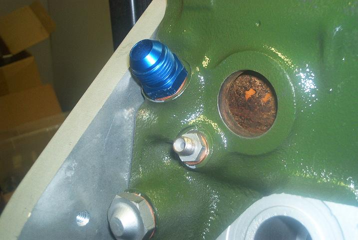

Ok, here's the intake side of external oil system, this special made oil block, Ray got this from Winners Circle, repalces the OEM oil filter housing.

Hap -
Fittings look great. I'm not a huge fan of the anodized red/blue. Does Aeroquip stuff come in silver, or black?
That freeze plug looks a litte ratty. Planning to replace it?
EDIT: oops, just noticed there is no freeze plug and that's the core. Doh!
Scott you can get steel AN fittings in cad plating. Red and blue is pretty much the industry standard on the aluminum race fittings regardless of what company you use, Aeroquip, Earls, Goodrich, etc.
Yep, that no freeze plug in the hole, that's the water jackets in the block, which look alot worse in the picture than real life, the block has been caustic washed, and a good coolant/water mixture will keep it from getting any worse.

On this shot, the oil comes out the same place as on the A series engine. The T fitting allows an oil temp sender to be installed right where the oil will be hottest, coming out of the engine. It goes from there to the filter, then the cooler, and back into the filter head.
The T fitting there is to hook in the accusump. The odd looking blue fitting below the oil exit from the block is a knock sensor. The thin hard line passing over the exit T and the knock sensor is the hard line supplying the cams (the engine is the DOHC MG version).
