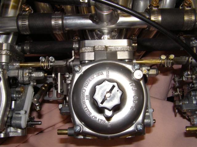

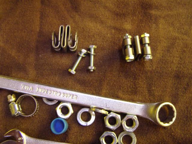

I am also having problem with my idle increasing
with the Ratco linkage. My problem seems to be reraled
to the folded metal between the two carbs.
The Ratco pull the folded metal at an odd angle and
deforms it. The more deformation the more my idle increased.
Is it posible to get rid of the folder metal piece and
install a straight shaft of some sorts?
thanks,
d
