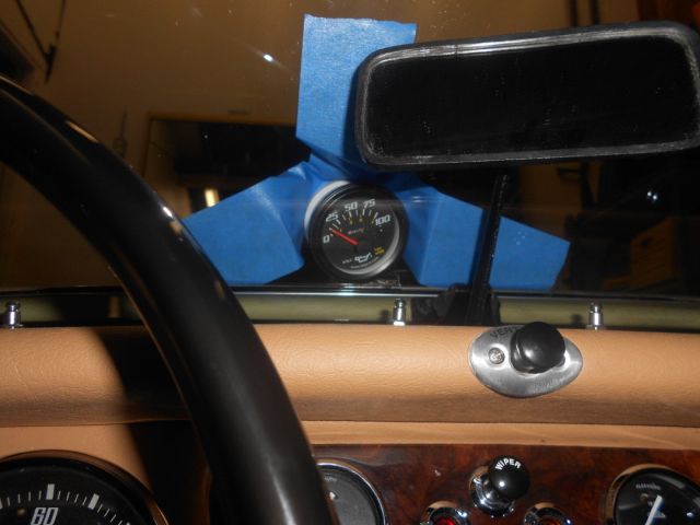

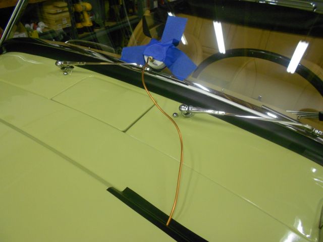

Well, it was the gauge. All the gauges were rebuilt and this is the 2nd one that hasn't worked in the 1st 100 miles of use :madder:
We hooked up a temporary and all is good.
Thanks for the helpful hints

one more from the interior
