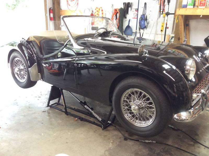

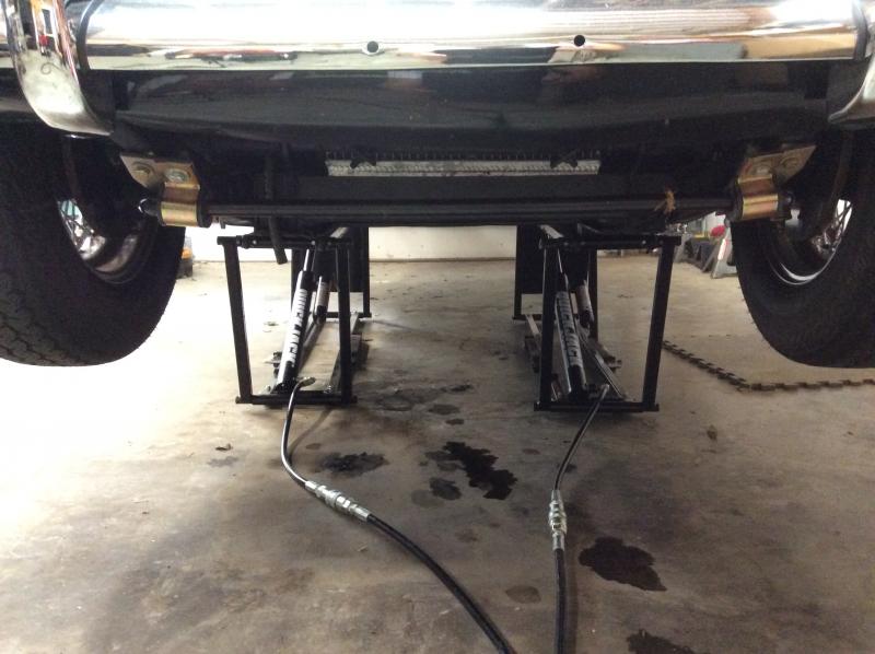

it is less than ideal for working under a frame car, especially a TR3 that is pretty narrow.
each scissor Jack is approx. 61" x 10.5".
but since the car frame is inset about 6" & the frames converge toward the front,
you must push the jacks (2ea) completely under the car, limiting creeper room up the middle considerably.
Also no access to the middle from the sides of the car.
not to bad, for access in the engine bay area or at the rear of the car. But not ideal for working on the transmission or anywhere in the middle.
Quickjack is a great lift for servicing wheels, tires area, as you can have the car up in about 2minutes with the safety braces down & remove all four wheels at once.

Well no takers on Craiglist, so I'm putting it to use.
replacing the rubber brake hoses with stainless steel braided.
the Quickjack is ideal for this type of work.
raises quickly & to the right height, stable, allows acces to all wheel wells at once without repositioning.
