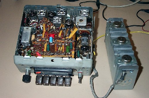

With time, aging of components, and vibration, these old radios often need a little tweaking of their adjustments. Unfortunately, as they get older, those adjustments often freeze, so you can't adjust them without risking damage. Below is a picture of a Blaupunkt radio I recently worked on. (It's from a ~1960 Mercedes.) The adjustments are the screwdriver slots in the square cans. The ferrite slugs in the cans are very brittle, and they were mostly frozen. The AM was still working, but I know I could have made it better if I could have adjusted it.

Yes, the Blaupunkt had a similar problem. The tuning shaft was frozen; turned out it was just in the bushing where the shaft goes through the front panel. Cleaned it with a little contact cleaner, then a tiny drop of teflon oil. Similarly cleaned and lubed the mechanism behind the pushbuttons.
I too am amazed at how they crammed so much stuff into that little box.
