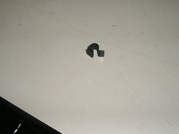

Kinda think I know the answer to this one just need a confirmation. I'm not quite sure where the clip goes, but it looks like it slips in between the fins and radiator exterior side. Does it go at the bottom of the rad or somewhere in the middle?

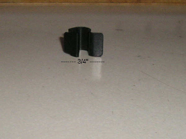

Down the RHS of the radiator (when you are seated in the TR), there is at least one (or maybe 2) hole(s) down the side frame of the radiator. There is (are) small spring clips which hold the hose (black rubber) to the side of the rad and the bottom end extends just below the bottom of the frame. These clips look like a "C" which forms about a 3/4 circle around the rubber hose and then both ends are folded outwards. So you place the clip around the hose, squeeze the clip and hose between your finger and thumb and fit the two open ends of the clip into the hole on the side frame of the rad. See the clip attached, but make one out of round wire and make the spring part round to fit around the hose.
It's very hard for a VTR or TRA judge to see anything down there so don't worry too much if you come up with something a bit different.

When I first got my TR3, a local club member came over to see it. He came over again shortly after I had the engine out and most of the car stripped. Of particular interest to him was "a very original piece" on the car. He was so excited about it, that I squeezed the clip, removed it from the holes as Randall described, and gave it to him. I can't say if it's in his car, but here's a picture of it prior to removal. The overflow hose fits inside this clip perfectly -but there was no overflow hose on the car when I got it.
Jerry
Re: Radiator overflow pipe clip TR 3A
That's exactly what mine looks like, including the wide, flat clip.
