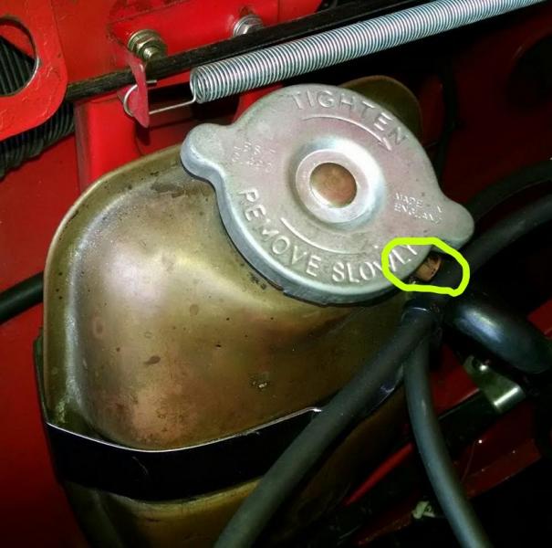

For Healey use, the tank needs to be vented. On my ex-MG brass tank, I had to remove the guts of a standard radiator cap so as to prevent it from sealing on the tank neck. You can also leave a stock cap loose on the tank.
If its an auto parts store plastic tank, just make sure there's a vent hole in or near the cap.

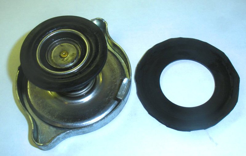

Your Healey radiator cap will need a gasket sealing against the radiator neck lip in order to create a vacuum as the radiator cools - this is what pulls the coolant back from the overflow tank.

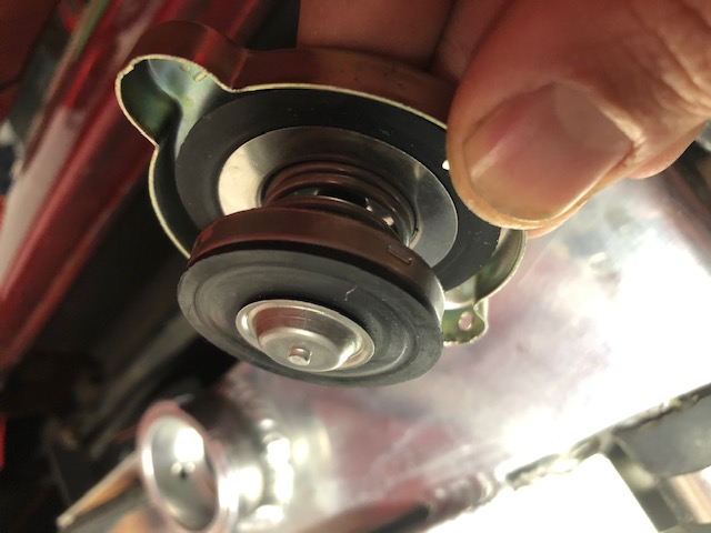

Easy enough to drill a hole in the cap. Here's a pic of the cap I’m going to use, looks correct. How would a non vented tank even work?

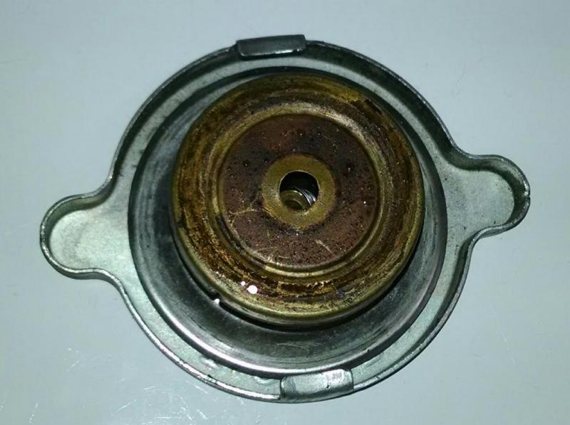

Your pic looks like a brand-new cap. Even has the needed upper gasket in place. If it's a 7 lb of the appropriate reach, why not use it on your rad and disable an old cap for the overflow tank. This is a stock 7 pounder I cut the lower rubber and valve off. Looks correct on the MG tank.
If drilling, you only would have to drill through the lower part as the MG neck halfway up has a vent pipe to atmosphere (yellow circle).

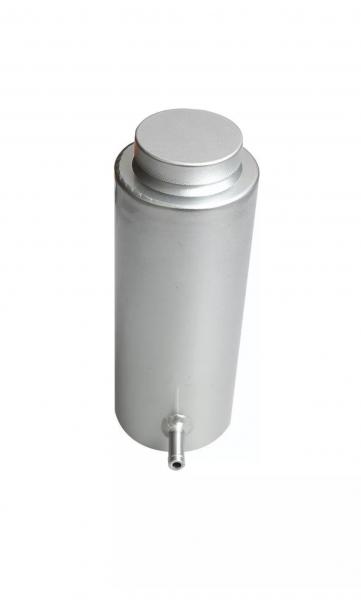

Yes Steve, that cap is the one I’m going to use on the radiator. I was talking about drilling the cap on the overflow tank. Here is a pic of the tank and cap I’m using. Not sure if I should drill the cap or drill a hole on top of the tank and use a barbed fitting and hose?
Nice tank. Billet!
Does it have a pickup in the bottom? What you want is a connection in the bottom for the hose from the radiator neck. That and a vent in the top.
The MG tank I show has a pickup near the neck, but internally that tube reaches down to the bottom. I always start with a pint or so of coolant in the bottom of the tank.
Thanks! Yes, it has a hose from the bottom of the tank to the radiator neck. I just have to put a vent in.
Just "thinking out loud" here - was looking at the billet recirculating tanks online (Jegs, Summit). If it has 2 pipes coming out the bottom, does one of the pipes feed from the bottom of the tank and the other from the top? If so, attach your radiator overflow hose to the bottom-feeder :smile:excitement:smile: and leave the top-feeder open for your vent.
No, this tank only has one hose hook up on the bottom.

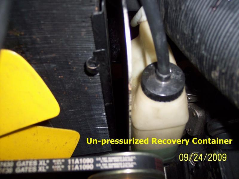

Since my overflow tank is out of obvious sight, I simply used a vented radiator cap with the overflow tube directing the overflow through a 1/2" hole drilled in the cap of a plastic container mounted to the passenger side of the radiator. When pressure builds, the vented cap allows excess coolant to flow through the tube and into the plastic container. Upon cooling, the vacuum of the tank pulls the fluid back into the radiator.
The overflow tank is not pressurized and filled with coolant to 1/3 capacity for the tube to be maintained below its surface so as not to pull air into the system on retrievel. I appreciate it is not as elegant or visually appealing but it is relatively out of sight, works rather well, and the cost of the system was the cost of the vented radiator cap. Although the cap is a non-common item, they are available for both LBCs and older American classics through NAPA (Balkamp 703-1411) and a number of other suppliers.
I appreciate you already have your container and a pressurized overflow will be needed if you intend, or have, mounted the unit any distance from the radiator. However, the container you have purchased could probably be used if mounted to the side of the radiator and rigged as I have described.
