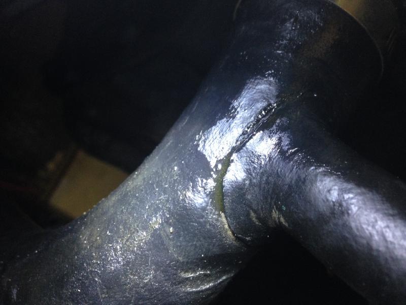

I had a Kevlar one, The hose was never used before but was lying on the shelf for a few years already. After installing the brand new hose appeared to leak. As you can see on the seam.

I had a Kevlar hose leak like this after it was on the car for a few years.

Used to get the same leak many years--like 20-30 years ago--on aftermarket hoses. I suspect the vendors/manufacturers got the word and the standard reinforced rubber hoses have been good ever since (with beefed-up joint at the heater hose).

How would that heater branch/take off be attached on a Kevlar hose? The original rubber types appear to be vulcanising of some sort.

The same way the original hose's heater branch/takeoff was attached.
It is not the Kevlar that is failing it is the rubber portion of the hose.
