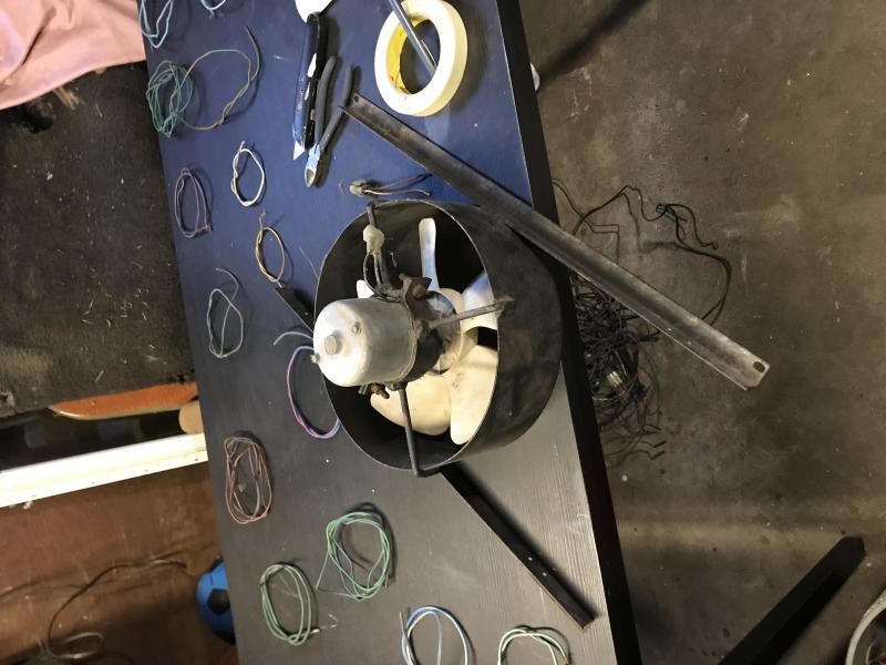

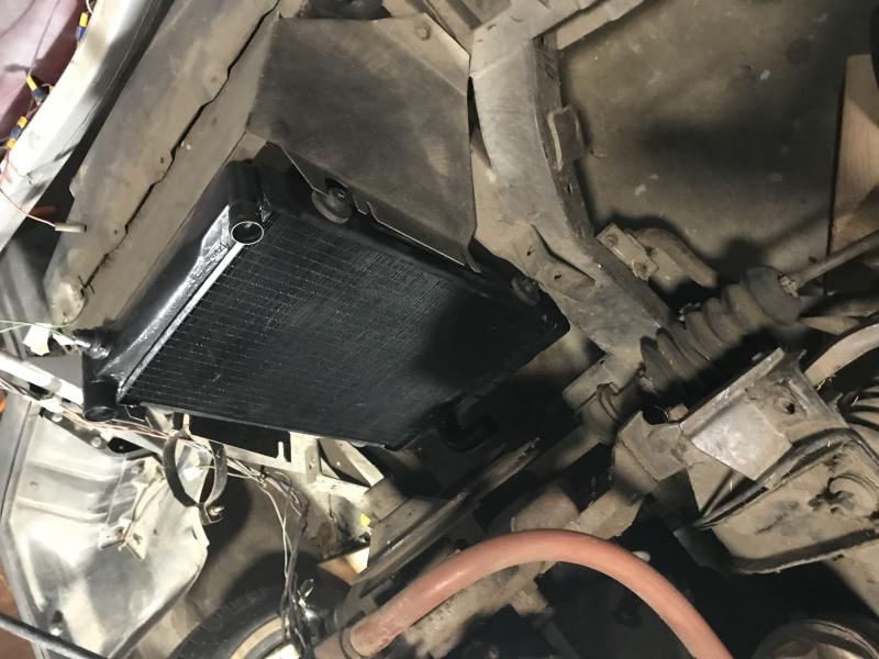

Still trying to get my '80 Spitfire back together. Today's challenge is the radiator. I can't find a good picture of what the finished product should look like. I don't see how my radiator is supposed to fit into the bracket. It's quite possible that I'm missing some key parts, but what those parts are... hopefully somebody out there knows. And then there's the fan. I understand they originally had two fans, but most folks have replaced them with one larger fan. My car came with one fan, and I'm not sure it even belongs to this car. If not, any suggestions on what I should replace it with?

I hope these pictures help.
Fan-frickin'-tastic! That's exactly the view I was looking for. And you confirmed that the fan I have does not go to my car (along with a lot of other stuff that was crammed into the body when I bought it, including a toaster oven, though I understand that a toaster oven is stock on several cars). Thank you so much!
