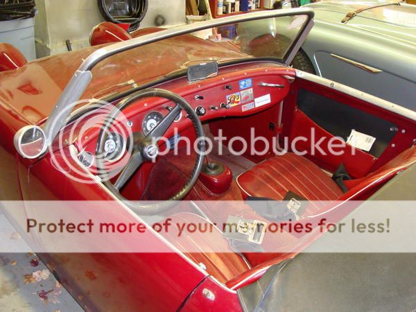

I want to recore my stock radiator since it's been 30 years since it was last done and the car has been running a bit hot. It's a 948 motor with a 12G-295 head from a 1098, 88G-229 cam, flat-top pistons with a .060 overbore, LCB exhaust and HS2 carbs and manifold. I want to stay with a stock appearing radiator (no ali ones on this car.) Any suggestions what kind of core I should be askig the radiator shop to install? (I've added some pics, since most of the pics on the forum are of my big Healey. I finished its restoration in 1986. Think I'll buy it a present of some more vintage looking competition seat belts this year.

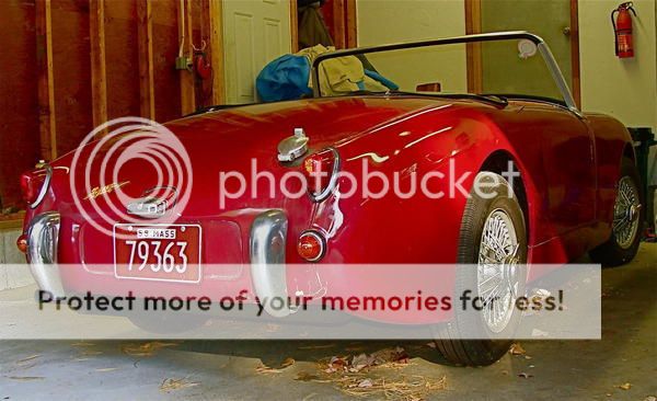

(Nice of Massachusetts to issue a complementary color plate to Cherry Red in 1959.) Colin Dodds 50th Anniversary Sprite emblem
Bunch of dash plaques and a John Sprinzel autograph to the left of the starter button from Rick Moses's Sprite events.

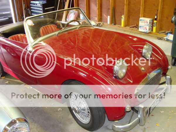

I got the "BUGEYE" plate made up at a Halford's in England when my wife and I visited in '78. Shop owner thought we were daft. The badge on the front fender is from the original selling dealer in Kassel, Germany (it was brought over with a returning GI)
At Speed!
