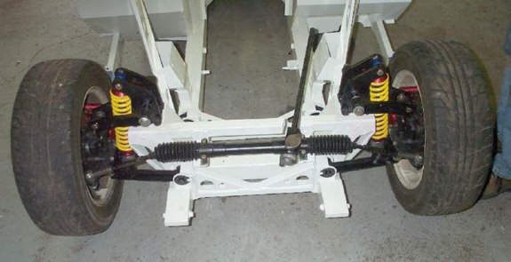

Michael Salter (Precision Sports Car in Canada) did this conversion from an MG B. An image is attached. More info is available at Larry Varley's website https://www.acmefluid.com.au/larry/ahx12-1.html
Michael did at least think about making a conversion kit available, but I don't know if he did or not. You might want to check with him: msalter@precisionsportscar.com
Hope that helps.
Lin
