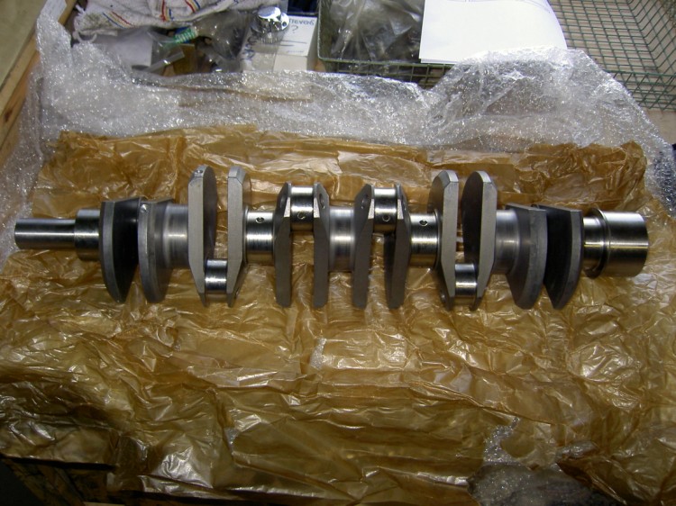

have heard some positive comments about racetorations,but to clarify how do you rate this firm for parts etc? have just recieved price for billet crank, made from en40b steel.looks promising,willpost pics when pc is behaving normally!thanks everyone. /ubbthreads/images/graemlins/cheers.gif
original crank

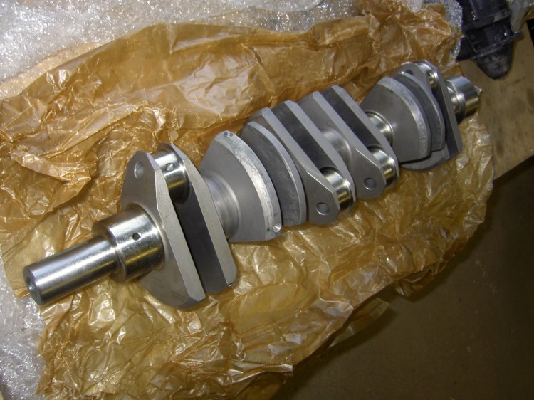

I believe DKU offers both: a billet crank that is a close copy of the original and another that "straightens" out the design using several dummy mains. The "straightened" crank shoudl spin up faster, due to lower interia. It makes sense to me and seems a clever idea, but unfortunately I don't know of anyone using it. As soon as I win the lottery, I do plan to try one in my TR4!
I think Darryl's crankshafts use standard flywheel fitment. I am pretty certain some others, perhaps from Cambridge Motorosport and Revington TR, require a special flywheel. Best to ask about this from any of the vendors, before commiting to a crankshaft (unless you are also planning a flywheel swap).
