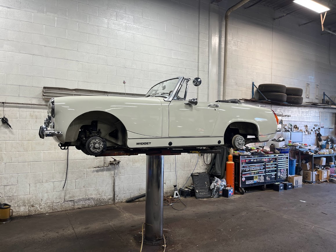

Suddenly began to wonder whether you could even use these on LBC's - specifically whether you can put it on a hoist on the jacking points of the pinch welds on the bottom of the body?
Here is a picture of mine on a hoist exactly like that so clearly it can be done. However because it can be done doesn't mean it should be done. I have never used the jack that came with it (side holes) for fear of damaging the paint. Thus I have only ever used my floor jack.

JP - what parts of the suspension is the jack supporting? Can you post a couple photos of the undercarriage while up on the lift?
I may be missing this entirely, but the one in your link looks very different from the one in your photo.

Tom you are correct - two different jacks. The photo is at my mechanic getting new rims installed. The car is supported by the hoist corners located at the very bottom of the body where the body connects to the undercarriage. This is the same spot any modern car would be supported if placed on a hoist, and, clearly it worked without damage.
That said as per the video, I don't know if our Little British Cars are meant to be supported at those points - and to the video Elliot posted, whether the Quick Jack can even be used with a Midget (or the Vauxhall or eventually the Multipla)
