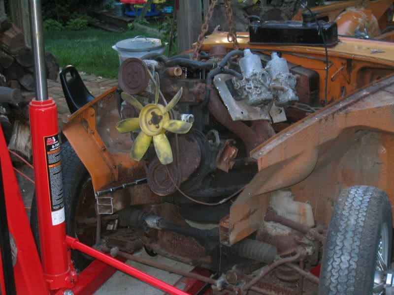

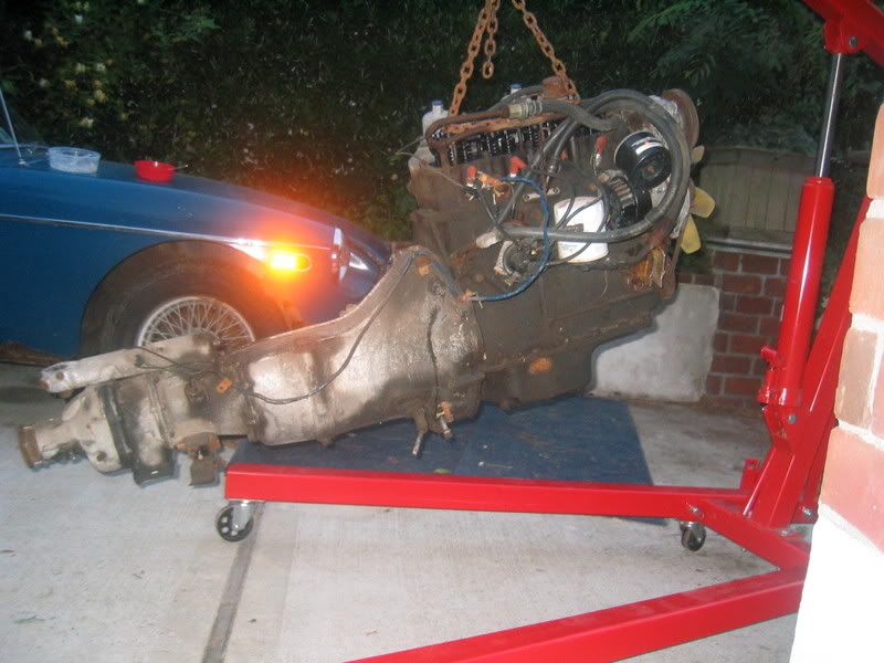

Not fot the squeemish but I had to get it out quick.

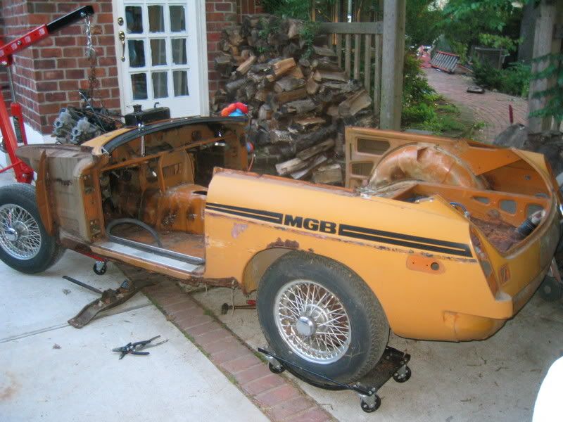

The N.Y. Chainsaw Massacre????????????? /bcforum/images/%%GRAEMLIN_URL%%/jester.gif
I suspect the sill covers can be polished up /bcforum/images/%%GRAEMLIN_URL%%/smile.gif
Yeah the sill covers are coming off. I'm just waiting for the WD40 to kick in and loosen the screws on it. Everything of use is coming off and I hope to have it cut up in the next day or two. The front end has no bolts holding it on and the body is just resting on it. The rear is the last major piece. Heater box a few pipes and the sill cover on the drivers side is the last of the savable parts. Making room in the driveway.

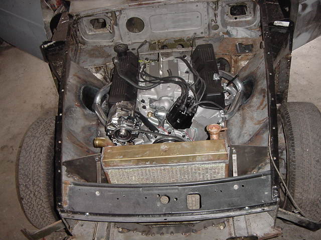

Actually, I did something similar to my B/GT V8 project to ease engine removal...
I have a removable slam panel. The old slam panel was cut out, leaving 6 inch "ears" on either side. New slam panel trimmed, fitted, and bolted onto ears of old slam panel.
The 3.9 litre Rover wil now slide in and out without much ado.
