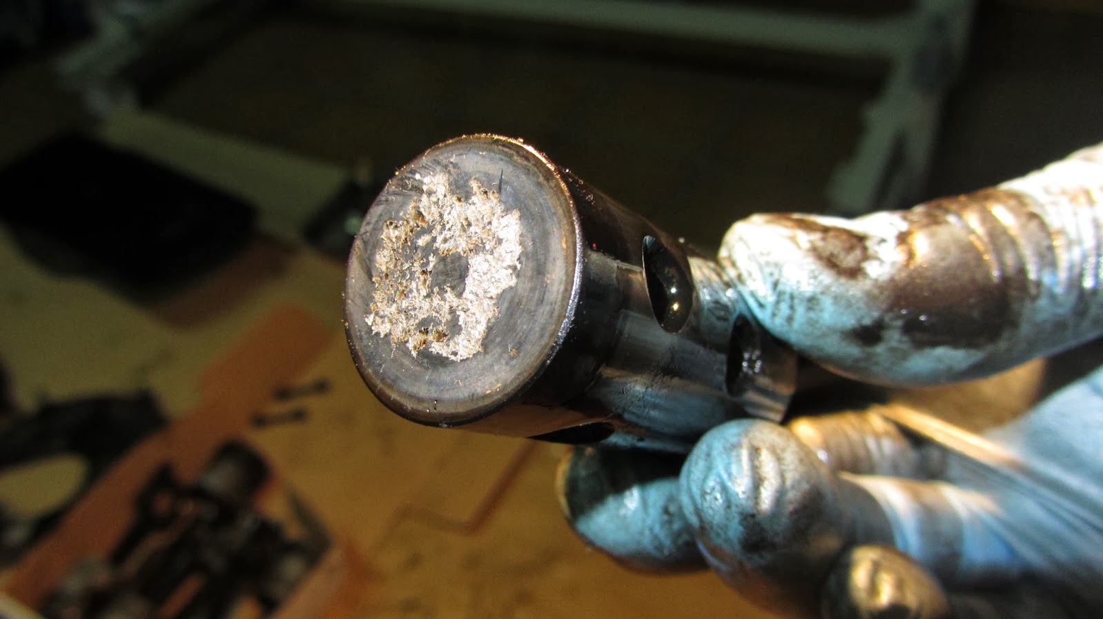

We have also noticed that the head of the cam followers are somehow "smashed", my friend helping me opening the engine, an occasional week-end mechanic thinks that it is not important as they probably do the same work being mirror finished or the way they look now, but told me to ask here just in case. Here are a few pics of them, what do you guys think?:
I am glad that you posted the cam follower question and picture. Your weekend friend is a little off on his comments. Do not reuse the followers or cam, it will cause you nothing but grief. The rough surface will create continued wear to the point that it will be impossible to set valve clearance. With followers that bad I cant imagine the cam being much better. Send out your cam and have it checked/ reground if needed, I had mine reground for 150.00, and then had the followers rebuilt for less then 80.00 shipped to my house.
Those cam followers are junk , just buy a new set .
Those cam followers are junk , just buy a new set .--Yep I sure agree with that-:congratulatory:
The more expensive ones are listed as 'Hepolite' which was a famous UK company from Bradford and a huge producer of quality pistons, rings and other engine stuff. It's now part of a larger group. I believe these pistons will still be cast, not forged. AH Spares sells forged pistons from their competition parts range which are even more expensive. For normal use the cheaper pistons should be fine. I don't think the original pistons were Hepolite.
Don't ignore this advice. Replace the followers AND the cam. They are a matched set. A new set of followers installed on the old cam will soon look like the followers in your picture.
I've always been able to have the lifters resurfaced with no problems. I only had 6 lifters that looked similar to yours and the rebuild of my engine was in the late '70's. I used Elgin Cams for both cam regrinding and lifter resurfacing for my current rebuild and I paid about $96.00 for the lifter service which included parkerize & polish & hardness testing. Dema also checks the new lifters for MOSS motors before they sell them to their customers. We can be sure that the company Moss uses(foreign) makes a good lifter and are tested before you buy them.
I had Elgin regrind my BJ8 camshaft with proper lube taper, nitride and no problem. This is the second regrind for this cam! I paid $484.00 for both cam & lifter work including shipping. It's a piece of mind that I'm using a high quality service shop for my work. Dimitri, "Dema", usually has cams for Healey's in stock for faster turnaround. He also provided me a sheet explaining oils and zddp with a recommendation.
Break-in is critical for cams and I used Joe Gibbs break-in oil plus I prime the engine with an pressure oiler to do it before start-up. I posted this pre-oiler in an earlier post on the BCF. I also shopped around for the work and had one bid to do the camshaft for $150.00 but that low price scared me off.
