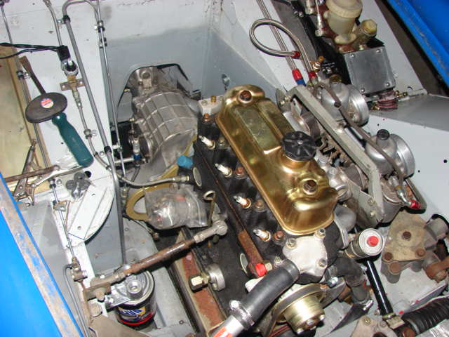

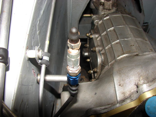

Drew, here's a DIY bleeder. I use it with my vacuum bleeder.
Jeff

My wife used to always whine when I ask her to come out the shop and pump the clutch pedal for bleeding, always a 30+ minute job. I got tired of getting brake fluid in my hair and installed my first remote bleeder years ago, ask her reluctently to come pump the pedal for me the first time with the new remote bleeder, it took all of 5 minutes, she looked at me, and ask me "why haven't you already had one of those". /bcforum/images/%%GRAEMLIN_URL%%/smile.gif
LOL, cause some of us do not have shops and want the clutch bleed now, not only that we only do it once every few years or more.
Not to say a remote bleeder is not a great idea, it is.
Hap
I like that idea. The last time that I had to do it was by myself, I became a contortionist.
Pat
/bcforum/images/%%GRAEMLIN_URL%%/lol.gif I know what you mean!!! It is actually rather amazing that one really can (if one is tall enough!) pump the clutch pedal while contorting over the hump to reach the bleeder through that little access hole!! /bcforum/images/%%GRAEMLIN_URL%%/crazy.gif

Hey Bugeye58, I have the same thing on my 59 Bugeye that ends in a "EzBleed" fitting?
I have not used it yet, I assume all I do is open the fitting and place a hose like I would do on a brake fitting and then pump the clutch pedal while the open end of the hose is fitted into a jar of fluid?
Yep, and if you are bleeding through clean fluid, you can direct the rubber hose back to the master. Don't do this if you are changing fluid.
Peter C.
Thanks for the pic, Jeff. I'm definitely going to look at some sort of similar setup. I've got all new brake lines (hard ones in hand, still have to order the proper braided ones) to put in once the old engine is out, so I might as well set these other things up as well.
