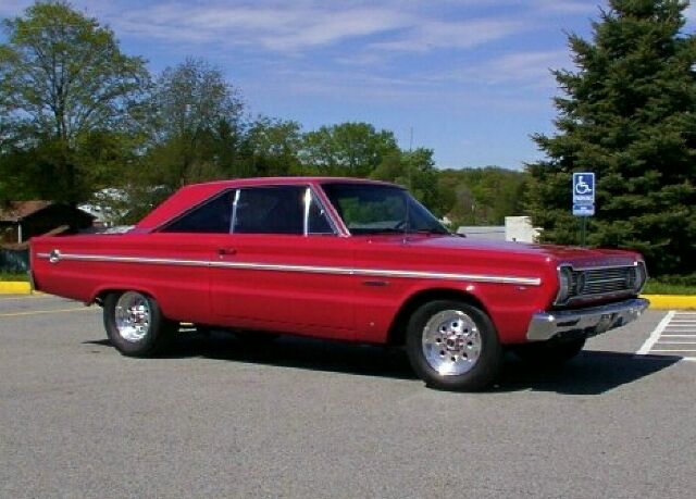

I have done 4 cars at home in my garage. It was a lot of work to make them come out good. the prep work on the car is the most important. second is a GOOD gun, the $99 gun will not give you a good finish. and no matter how good you are, alot of time will be spent on wet sanding and buffing. This is were the real shine comes out. I like base coat clear coat. do not let anyone tell you that it is harder to repair. My last 2 cars won many awards and trophys. But my Sprite will go to my friends spray booth. I will prep it, this is were most of the time and money is.

Her is a picture of my last project
Carl
