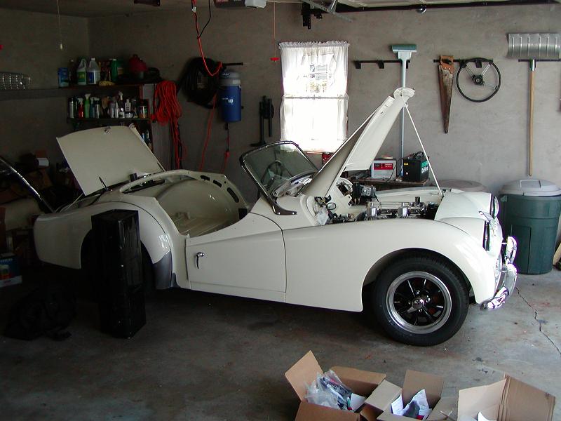

Thanks to all! Problem appears resolved. Can't be sure exactly what I did but my best guess is that the wiper hot wire and switch wires were reversed. I took everything apart and reconnected using the wiring diagram in the above link and now everything works. Going to fill fluids this weekend and try to start her up. Car has been off the road since 1968. Here's a before picture.

[ QUOTE ]
Picture of progress to date attached
[/ QUOTE ]
That is sweet! /ubbthreads/images/graemlins/thumbsup.gif

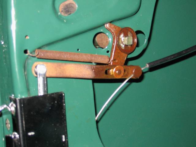

Jim - Compare the door handle mechanism with the attachment. It may help to set your door handle horizontally like it should be.

Color is old english white. I've got the red leather seat covers and interior panels from Heritage yet to install. The door mechanisms are not yet installed either thus the door handle position.
