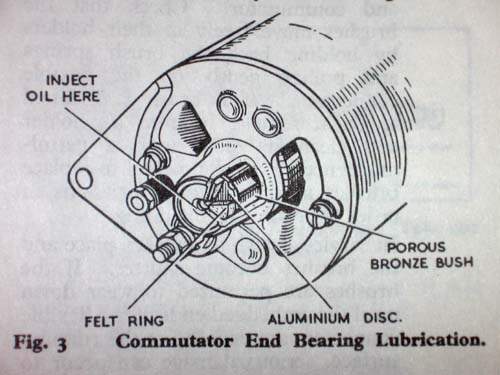

The front ball bearing is sealed. The rear bushing could use a drop of oil from time-to-time. Same with the starter motor. There may (or may not) be a cover over the rear bushing.
Most of the TR generators I've seen have a small hole in the back to squirt some oil in.
All of the original ones I've seen have the hole. The early books say there should be a small rubber plug in the hole, but the later ones don't mention that, so I guess it was deleted.
The original front bearings were open and could be repacked; but most of the replacements are sealed. Probably not too many of the originals still in service.
