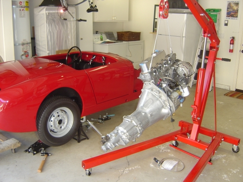

I bought a cherry picker from pep boys for $120 ($140-$20 mail in rebate). It's a solid one that I am happy with. Once I am all done, I will probably try to sell it on Craiglist for (hopefully) $50-80.
This way, I can have unlimited use, and likely only pay about somewhere around $50 total, which seems very worth it to me. Just an option. I have attached a pic here
Mustafa
YES! The engine is IN! and only 4 months after I bought the cherry picker!! can you believe?! hehe
That's the ticket.

the Oberg is the one i bought too...you can actually see it in the photo. Also note the computer in the background on the washer with, among other things, BCF loaded on the screen...
