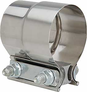

When I put the header on my B' I found some stainless band clamps that actually wrap around both pipes, and is held fast with two bolts and a piece of tapered aluminum that cinches the band around the pipes.
They look like this picture I lifted from Jegs.
