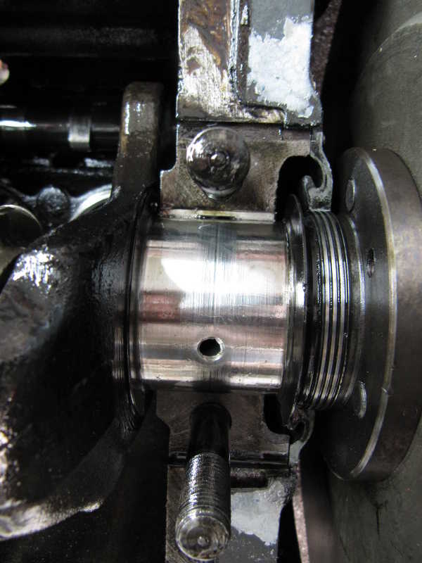

3. How do I tell if the journals really need regrinding? The front and center don't look bad to me, but the rear one has a clear score line around it, maybe a couple mils deep, just enough to be visible and feel it with a fingernail. It's actually in the center, so it's under the oil groove, not really in the bearing surface.
I've attached a picture of the rear journal, although I realize it's hard to evaluate a crank just from a picture like this.
First off, I am NOT a professional machinist nor an engine builder. That being said, IMHO I would grind the rods and leave the mains alone. If that picture represents the worst case journal you have no problem there. Possibly the crank man will suggest a polish job, that should be enough. Bob
I would echo exactly what Bob said above, including the part about not being a professional, but if you mains are in spec get new main bearings, and call them good with a polish from the machinist
Depends on how the car will be driven and to what extent you want the engine to keep it's strength. The rod journals are chewed. Did the rod ends themselves get hot enough to distort? Have the mains gotten hot enough to distort. You only show a bare crank journal, what is the coloring on the bad bearings. You are going to put some money in making it right might as well do the rod and main journal distortion measurements and correct. I assume the PO knew what happened and discounted appropiately so you really aren't out that much more for a build up and regrind to specs, then know you can run a club tour or a group trip without worry. Besides you now have to wonder if there is build-up of bearing sludge in the oilways.

Good point about the rods and distortion; there was nothing obvious, but I'll look into it more deeply. Interestingly, the top end is still fine. Compressions were really good, and I ran a bore gauge down the cylinders; they show no taper or out of round within a half mil. Interesting that the cylinders were unhurt, but the crank was badly damaged. The camshaft is in bad shape, but just from ordinary wear on top of previous regrinds. I'm replacing it.
Also, I really should measure the main journal diameters. One of the rod journals looked good, for example, but it was 3 mils undersized. Might have been a bad previous grinding job, but one never knows...
I hadn't thought about simply polishing the main journals. I suspect that might be enough.
As for use, I really don't think I'll be driving this car much, so it won't get any great stress. I really don't want to replace the crank unless clearly necessary; they are scary expensive. Of course, I'll get it magnafluxed when I take it in for grinding, and if it's cracked, well, that answers that...!

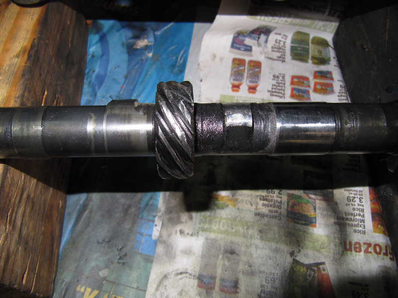

Fortunately, the valves, rockers, and lifters look good. Funny that the camshaft lobes had a lot of pitting, but no scoring, and the lifters were perfect. Seems that just the crank and bearings were damaged, although it seems strange to me that the upper end stayed OK. The cause of the problem is clear, in any case: the oil pump drive gear on the camshaft broke, and probably the mating gear on the pump jammed in it and broke, too. The PO replaced the pump, and it actually worked, for a while, but I'm sure that eventually it would have jammed again. Anyway, I have a new camshaft on order, and I'll take the crankshaft to the shop. I can measure the rods here, and if questionable, they will go too.
