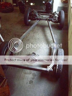

I'm building a 1920s-30s style roadster loosely similar to the little Austin 7 "TT specials" (or works replicas) that existed at the time. Among other places, these cars were raced in Ards, in Ireland, not far from where my family is from. My Dad remembers seeing "cut-down, baby Austins" racing in Ards.
Mine will have an Austin/BMC 1275 engine and trans but all else will be fabricated or adapted from other cars. Front suspension is from a Sprite (including the subframe) rather than the A7 live axle. Rear alxe is also Sprite. Tires are 135-15s. I'm using a flipped, shortened and reversed Sprite rack for steering.
I think I will get more done in the Winter, but I've had the thing rolling about as a bare chassis for a while. It's sqeezed up against the Spridget right now...wish I had a bit more space in my little workshop!
These pictures are bad, but it will give you an idea of where I'm at right now.
