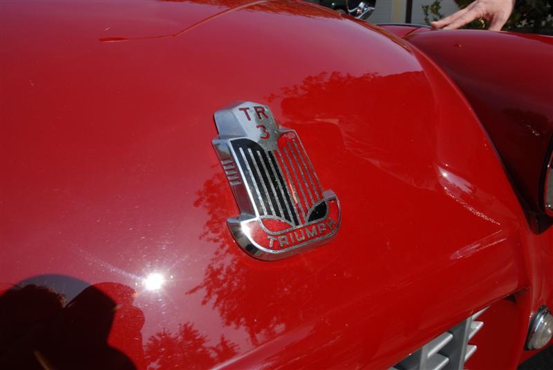

The TR2 and TR3 had no big lettering across the front. The name Triumph was inside the bottom of the badge on the front apron or valance - like on the red TR3 attached. Then the US Sales people asked Coventry to make the name more visible because the general public couldn't read the name if they were more than a few feet from the front of the car. So with the introduction of the wide grilled TR3 (later called the TR3A by it's owners), the name Triumph appeared across the apron.

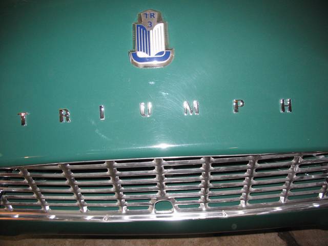

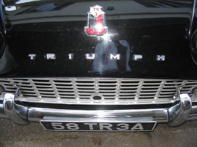

The early TR3As - like my black one attached - had grooved letters. Later TR3As - like the green one I finished in 2006 - and some TR3Bs had smooth letters. I say some TR3Bs, because, as the story goes, the factory ran out of letters and so some TR3Bs came to North America without any lettering across the apron.

Nice examples of the lettering possibilities. Since Don's pics also show 3 of the badge styles used I'll add a photo of the fourth flavour -- the 3-color version used for a limited time in mid-59:
No idea why they tried this and the discarded it -- perhaps it was more expensive to produce with the additional color (black). At times Standard would seem to change something just to save 20p as they could be very price conscious.
While looking at those photos I am reminded you will also encounter 2 types of grilles. For many years the only repros available had thicker cross pieces and hence slighly smaller openings. I believe repros of the original dimensions are now available. Can't quite tell from Don's photos... perhaps his black one has a grille with the smaller openings?

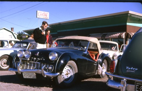

George - At VTR a few weeks ago, I saw a front badge with the black bottom. I had never seen one before.
Yes my grille has the smaller openings. I bought it back in 1987. It's been on since 1990 and has 97,000 miles on it now.
To get my grille to fit (also on the green one) so it would be flat, we used a very short hydraulic jack and a piece of 3" by 3" pine about 2 feet long where we band-sawed the curved contour of the top of the grille opening. Then we jacked up the top curve on the apron. We did this before it was painted.
I still have my original grille but it really got mangled in the over-night Echo Rally on the Rouge River road (gravel and rocky) back in 1963, when I took off at the top of a hill only to find the road had curved towards the right. A fence post saved me from crashing down about 15 feet into the rocky raging white water river about 3 AM.
