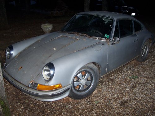

I have a friend who has a 69 911E that I'd like to buy from him. He's set a price finally at $3000. Here's its story...when his wife divorced him in 1985, she took the keys and it has been locked in his barn ever since and still is. It was running when he last used it but he said it needed a new exhaust manifold. It also needs new paint, tires, battery, interior, etc. and needs a general restoration. Body is sound with no rust but being locked, I haven't yet looked under the hood, trunk or really inspected inside it. My fear is that I'll get the car for $3K then will need to spend another 5 grand just to get it running again. I restored my 64 MGB. It had also sat for 15 years and I got it running for a just a few hundred bucks then another 2 grand on paint, interior etc. but that was an MG. Should I worry with a Porsche?

SH, The car looks good but your fears are not unfounded given that Porsche parts are very expensive. It also seems a bit odd that if the only thing that stood between the PO and access to the car was a set of keys why didn't he just call a lock smith or even easier present valid ownership to any dealer and a set of keys would be made up for a relative small price.The 911 is a very desireable model though.---FWIW--Keoke

[/ QUOTE ]Don't want to sound too negative, but there were problems with the fuel injection in the 911E in '69. For that reason, it has always been less in demand than the originally cheaper 911T and, of course, the top-of-the-line 911S from that year. The most desirable '69 is the 911S Targa, but the 911T Targa makes a better street car/daily driver. The Targa from that year had the glass rear window instead of the plastic, zip-out rear window of the earlier Targas, which also makes it more durable and leak-free.
And, of course, Porsche repair parts for any model year are, well . . . PORSCHE parts (ie, "Porsche" in German translates to "expensive" in English)./ubbthreads/images/graemlins/devilgrin.gif Good luck!

If you can do the work yourself, it might be worth a flutter. But, get a new key made (or get the originals, or get a locksmith to unlock the car), and give it a thorough going over before handing over any cash. If the seller's your friend, he'll likely agree to that, eh?

The only way to do a non-runner 911 is to get one REALLY cheap, like I did. I purchased a 1970 911T (carbed) with a seized engine for $1000. Paint and body were perfect. Interior was serviceable. It cost me $2800 to get a rebuilt engine installed at my home by a regional expert, but I received a special discount for being an auto journalist. Plus I gave up the original engine as a core.
I actually wound up selling the car, and got much more money than I expected, but if I had to have had it painted, I would have been under water.
If you want a 911, buy a complete running car. You can't expect to get it running cheaply, since, unlike our LBCs, they are more prone to catastrophic failure if they are running poorly. (Read: timing chain tensioners!)
