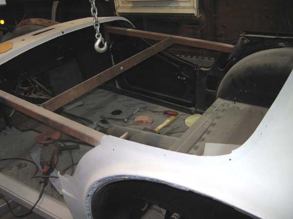

Haven't BTDT myself, but one method of bracing that sounds easy and effective is to use EMT (metallic electrical conduit from Home Depot) and bolt it through the trunk and hood hinge mount points. Obviously you'll have to bend it to match the body contours.
Here's a pic on how I did it. After bracing the door gaps and bolting to the body, I welded in a cross piece and drilled a hole for the hook for the engine hoist. The engine hoist is great for removing the body, as you can roll it around.

A few pics of my door bracing using the stock fasteners at the door striker postion and door hinge position.

While I agree with this method, in some cases, including mine, I don't have enough room in my garage to pull the body off and set it aside somewhere while I was working on all the frame stuff. I needed to roll the body outside for the day on the hook, and then bring it back over the frame each day. In this case, it was more of a semi-permanent lifting jig, placed in such a position so I could still work on the body without getting too much in the way.
I probably had that body on and off fifty times. Lack of room forces one to take other steps to get a job done. I guess that's why it took four years to restore this car. But I'm not complaining, I enjoyed every minute of it...well most minutes anyway. :laugh:
