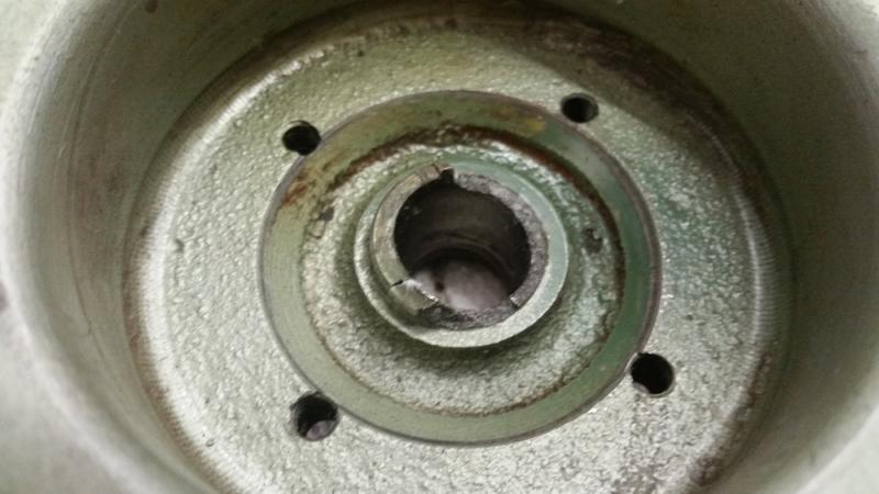

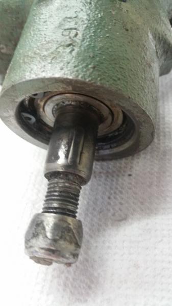

While the Moss parts diagram shows that there is supposed to be a key (part #55). presumably to engage the pulley, there is no keyway on either the shaft nor the pulley and of course no key--Instead there is a raised section on the shaft which is apparently supposed to engage the pulley (see photo). I also noticed that there is a bit of material missing from the inner shoulder of the pulley (see photo), perhaps damaged by the pulley's having wobbled.
I am concerned that the parts I have do not seem proper and am hesitant to reassemble everything merely relying upon friction and a press fit. Has anyone had a similar experience and/or any suggestions?
