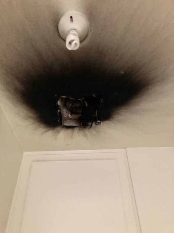

She came home to find the vent fan in the laundry room burned to a crisp, with soot all over the ceiling and melted plastic on the floor. Some of the wood in the attic was badly burned, along with the wiring. The circuit breaker had tripped, but apparently not soon enough.

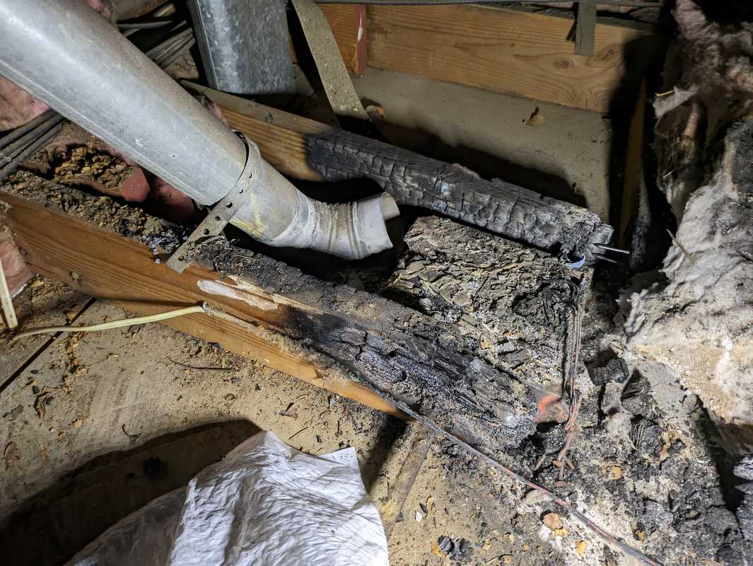

From inside the attic, we could see that a 2x6 beam, fortunately not structual, was burned for about four feet. The wiring, stapled to it, was melted. In the picture below, the square pile of ash between the burned wood is the carcass of the fan.
Anyway, I cut out the burned wood, cleaned things up, and replaced the wiring appropriately, cutting the wire back to the unburned sections and using junction boxes for the connections. I also reconnected the TV/internet cable, which had been burned through.
