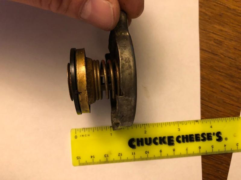

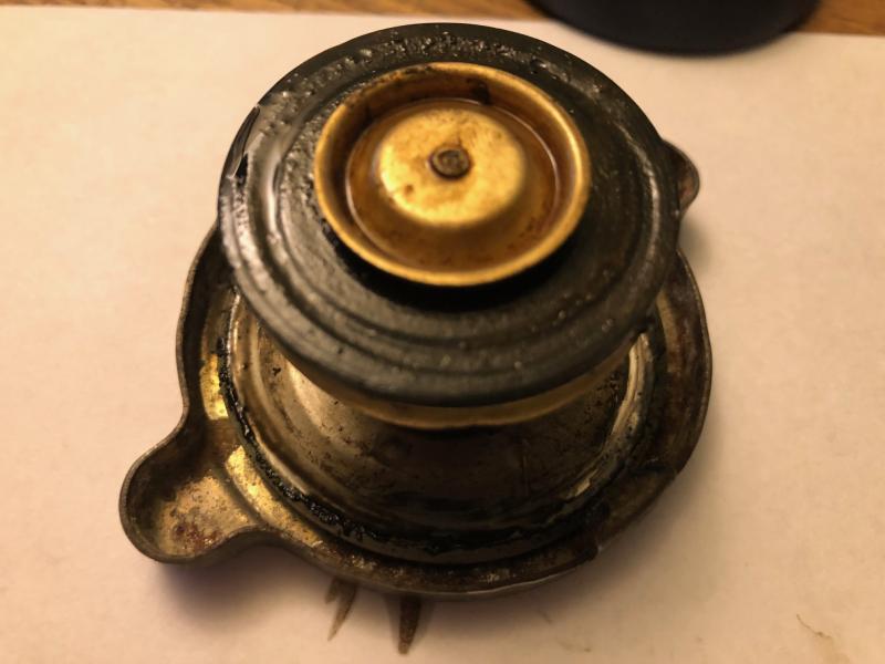

That looks to be correct. The reach is about 1".
