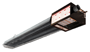

I use a natural gas infrared hanging above the bench. It's about 8 feet long and it keeps the garage toasty and the top of my head. have to wear a hat if I'm at the bench too long

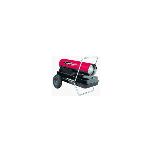

I use one of these 105,000 BTU Kerosene Forced-Air Heater in my large shop up north 30x50 we use Diesel fuel just crack the door open. Takes the temp up really fast with no bad smells.
Tell Me More :smile:
(that's the tagline/slogan of my employer ... https://www.airproducts.com )
Cost? Complexity of install? I have gas alreadly plumbed to garage /bcforum/images/%%GRAEMLIN_URL%%/smile.gif

That is *cool*. Need to engineer some venting; might be a challenge for me, as I have a room over the garage. Can you PM me an approximate cost for the unit you have?
Who?
