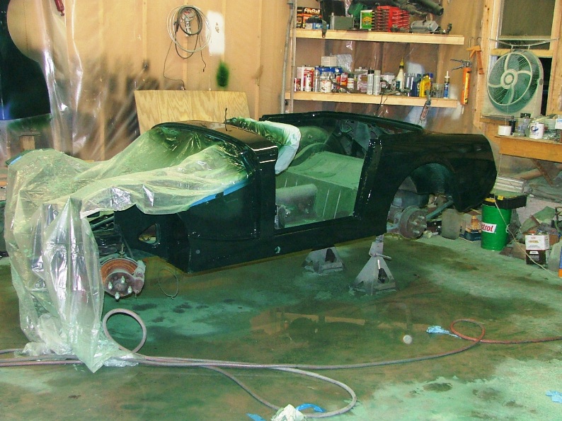

My new paint gun arrived yesterday so today I got a coat of paint on the tub and panels. Some assembly required.

You must have a heated shop!

British Racing Green??

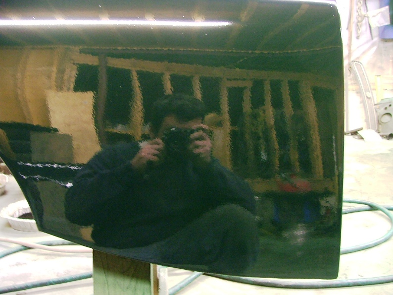

I'm particularly impressed w how you painted an image of yourself on the fender!! :jester:
-Bear- :cheers:
Yeah, dem new fangled camras...
Nice anyway - my 29F hat's off to ya!
What gun did ya get?!?
Car's gonna look a bit odd with that picture of you painted on the side...

I just got a lot of three used ones off ebay, a siphon, a touch up and a HVLP. I took a chance that the HVLP would give a decent finish but it seems to be pretty good. I can't justify a high end gun for single stage paint in a dirty garage with almost no air movement / filtration. Yes there is lots of dust, but that is to be expected.
Trust th' siphon one best.
Well done.
A little orange peel on the door?
Orange peel I can live with...a little sanding and buffing and nobody will ever know. But dirt is just aggravating. There isn't much you can do about that.

Nial - I couldn't find a good (ie up to date with todays pigments) formulation for dark British racing green (GN29) so it is actually the Miata BRG from the NA model line. Fitting I guess since Erica's race Miata is BMC glacier white.
Years ago, I couldn't find a good GN29 formula. I went with a BRG from a 2002 Aston Martin. It looks very similar to what you have on your car.
