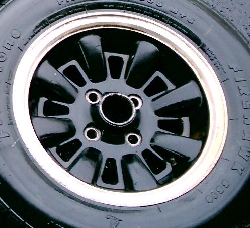

You're not gonna race on those wheels are ya?
No Tony, I have a new set of Hoosiers; just needed something to move it around on. Someone painted those rims maroon for some unknown reason. I figure they mike look like they serve and actual purpose if they have over spray on them.
By the way, the color is white even if it looks green in the photo.

I meant the early Rostyle wheels - you are going to use something else so you don't damage them, I hope.
I'll swap you a set of regular Midget Rostyles for those....hehehehe
OK, now I know what you mean now. No I won't run those, I have a set of Chevy Cosworth Vega alloys (see attached) for it. Not much lighter than the steels but the steel Vega wheels are too soft for my liking. I'll use them as spares.
