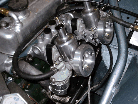

The air filter are the KN universal cone filter we use on the race cars, and have started using on the MGBs as well, as the MGB factory velocity stacks for the HS4s have a 3.5" OD, so the KN filter silps right on the MGB velocity stacks. Unfortunatley the same type set up did not exist for other cars with other than HS4 carbs, so I had billet aluminum velocity stacks made for a the HS2s and HS6s with the same 3.5" OD to utilze the KN filter, the billet one we made, we made improvemtns on as well, more radiusing per CNC in increase air flow to the carb opening. No pesky backplates to deal with, and nothing more than a clamp to loosen to remove the air filters, making the carb much more user friendly to piddle with, and no better set up for airflow to the carb.
Hap, are you saying that the K&N just slips on the OD of the velocity stack and attaches with something like a hose clamp? It sounds like a very clean installation.
That's exactly how it works, Doug. Very slick.
Doug, here ya go, here's look with the filters off. Even better the stainless steel clamp even comes with the filter, the filter part number is KN RU-4410. We've been doing this on the race cars for decades.
