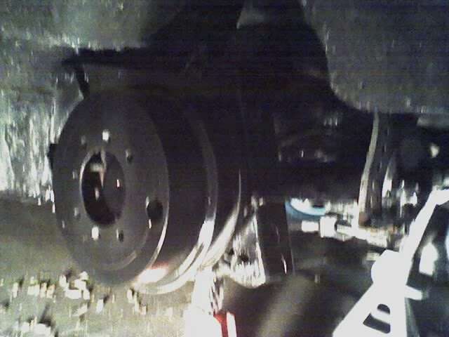

I received the rear brake shoe springs from Carl (many, many thanks!!!) The rear end is just about completed, so hopefully this weekend I can start connecting up the engine.
