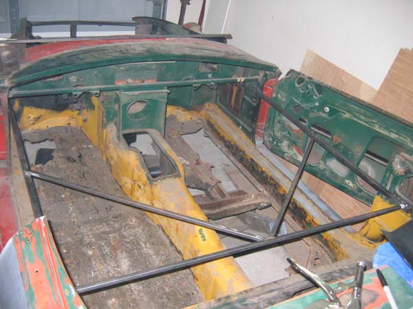

Broke away this evening and made some repairs to the L/H Seat frame. Since I had the welder out, I decided to go ahead and brace up the the shell so I can safely (somewhat) remove the sills/rockers/floorpans without having to worry too much about undesireable flexing and twisting.
Baby steps...

Great idea Mike! My compliments to you on the idea. Now your doors will fit after all the body repairs are made! /ubbthreads/images/graemlins/thumbsup.gif /ubbthreads/images/graemlins/thumbsup.gif PJ

Looks good. I'll want to see much more as time goes on as I need to do the same. I would add a diagonal across the door though.Your frame will keep door openings parallel but sagging can still occur. Run a diagonal from top of jamb to near sill area.

I'm not as concerned as I probably should be on the sagging since I'm not going the rotisserie route. The shell is probably going to stay supported on the main frame rails so my main concern is folding. That's why I put the door supports as high as I did. That's a good idea though - I really hadn't thought much about that until you mentioned it.

Good job, many forget to do this and then wonder why their doors won't fit.
