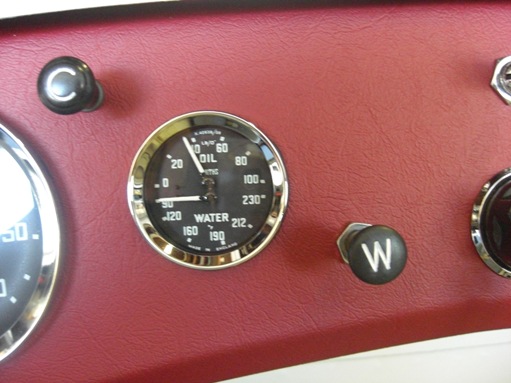

First I had to re-route the line from the block to the gauge, as it was interfering with the distributor (specifically the vacuum advance thingy). I spent a few minutes with my trusty pipe bender and all was well. I reset the static timing and decided to give the oil pressure a try.
Hap had given me a few tips on getting going. I pulled off the fitting that goes to the oil filter, and tried to crank the motor. Nothing (no cranking at all). Ahh, I've seen this before... a minute spent with some rubber insulation and tape to keep the starter cable from grounding out, and I had a spinning motor.
Hap suggested that this method should allow me to see when the oil was starting to move from the pump. I wasn't getting anything, so I followed another suggestion of his and poured a bit of oil down that opening and rotated the engine backwards to pull it into the pump as a priming method. Once that was done, it was back on with the fitting and a bit more cranking -- and checking for major leaks (none found so far).
A quick move to where I could see the oil gauge, and in a short time (less than 1 minute) I had pressure at the gauge. Woohoo!
