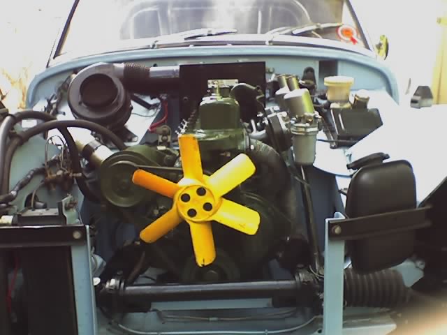

My brother got on my butt about the progress so I endured the heat today.

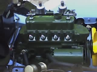

one more

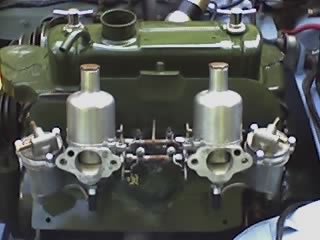

last one
Maniflow, tilted 20 g. I have a question regarding the oil pressure - positive crank. The new carbs do not have provision for them, is there some other way to hook the crank vent up?
Patrick
Sorry, angle of pic, you can see in the first one that they are pretty level with the head.
Patrick

Nuts, I missed the carbs in the first picture!
Are you running the 1275 timing cover, with the oil separator built into the vent?
You can always tee the hose from there to the hose from the valve cover, and run it to a vented catch can.
Patrick, yes, just tee the two hoses together, and run the hose from the third leg of the tee to the catch can.
Are the carbs HS4's?
Jeff
Thanks Jeff.
I have a nice spot to mount it. See the pevious post for attachment, HS2's fully modified.
Patrick
Gotcha, Patrick. It was hard to tell from the original pic if they were HS4's, or modified HS2's. I've got a couple of sets of each, both highly modified, but for race use only.
