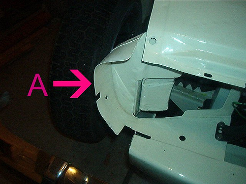

Does tab "B" fit over or beside bracket A. which is to ask, does the tab help hold the fender in place or just nestle up to the grille bracket?

Imo, comparing the profile of the lip of bracket A to the picture of tab B, I'd say the lip of bracket A fits behind tab B, helping to hold the fender to the body.
Tab B fits over A. On the later MKIIIs like my 73 there was a pop rivet installed through the aluminum surround trim that went into that tab, so it had to be in front.
Bill, you are more knowledgable than I! :smile: I can see that orientation too....
