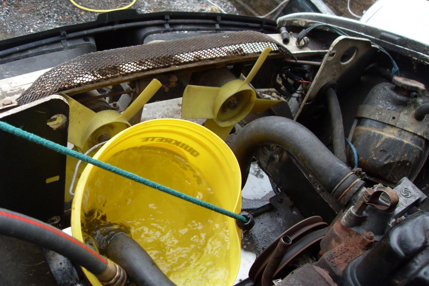

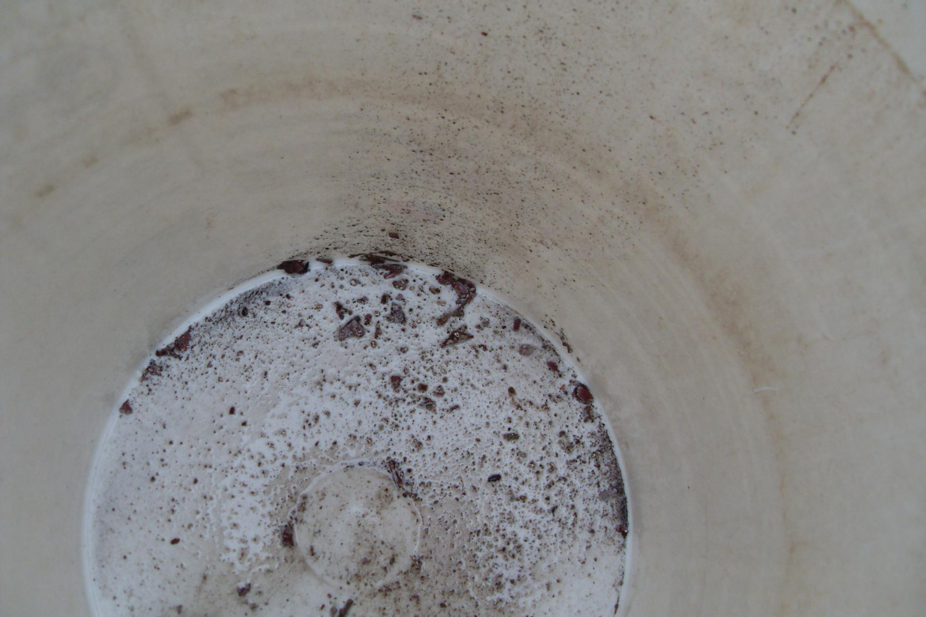

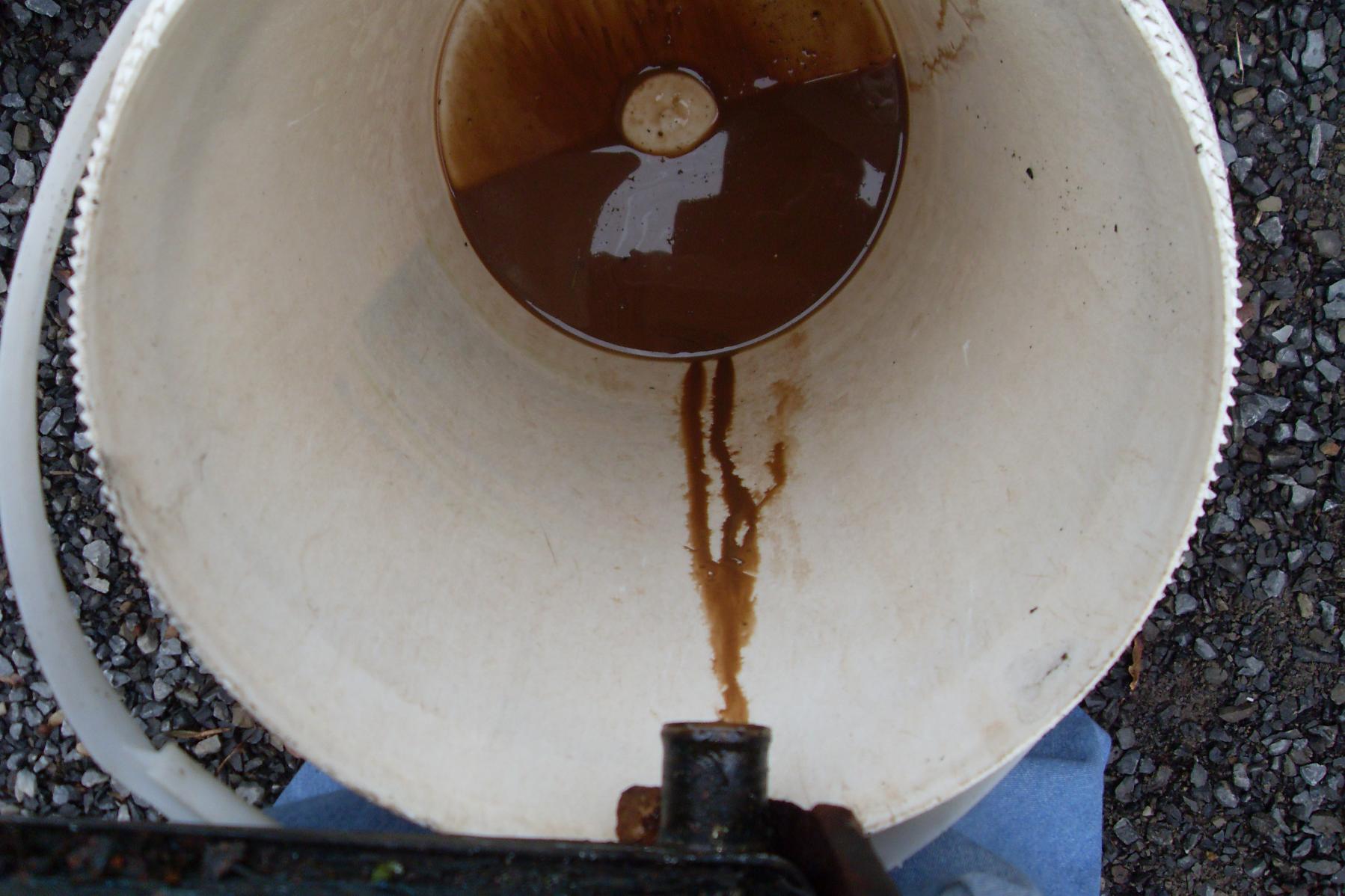

well combined efforts of a few days. yesterday i pulled the radiator as the color of my coolant made me uncomfortable. Put the bottom rad hose in a bucket full of water. Then a larger bucket set up under the upper rad hose to catch what comes out of the block. Ill tell you nothing nice came out of there. When it started running clear I put both hoses in the same bucket and added CLR. Let that suds up for a bit and have been running a few cycles of water to rinse it out. Over all im pretty happy. the first pic is what came out of the radiator. the middle is the hose filling a bucket that the water pump is sucking from. the last picture is rust that stayed behind after i dumped the bucket the system puked in.

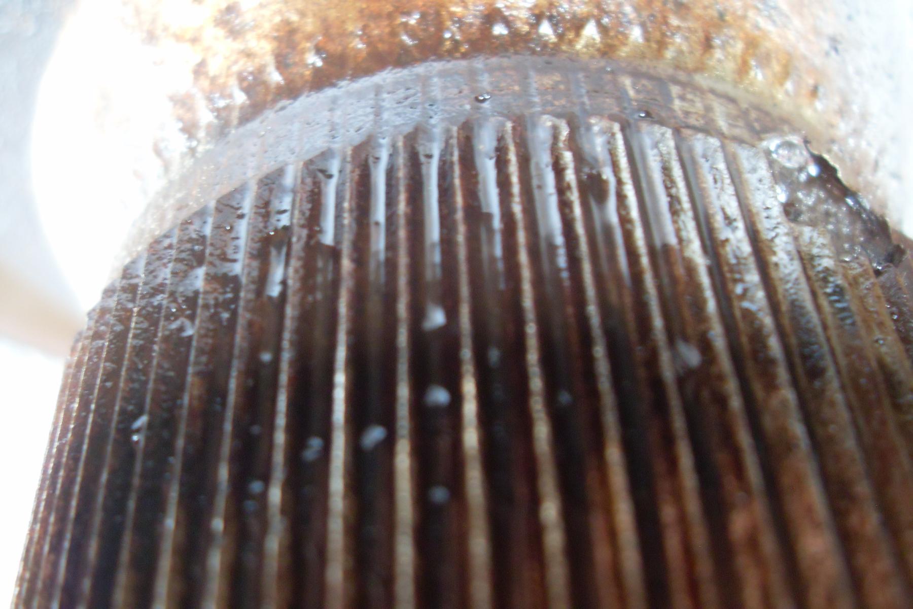

I got my wire wheels back with the snow tires on them. Time to clean off the grease on the hubs that had been on there before i put it to sleep a few years ago. the shiny spots you see in the picture are hardened grease that did NOT want to come off. After a few hrs of "elbow grease" ..... ba da dum. All are shiny and ready for some grease.
