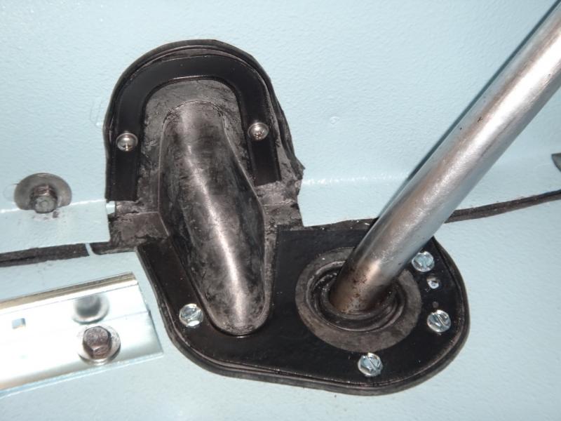

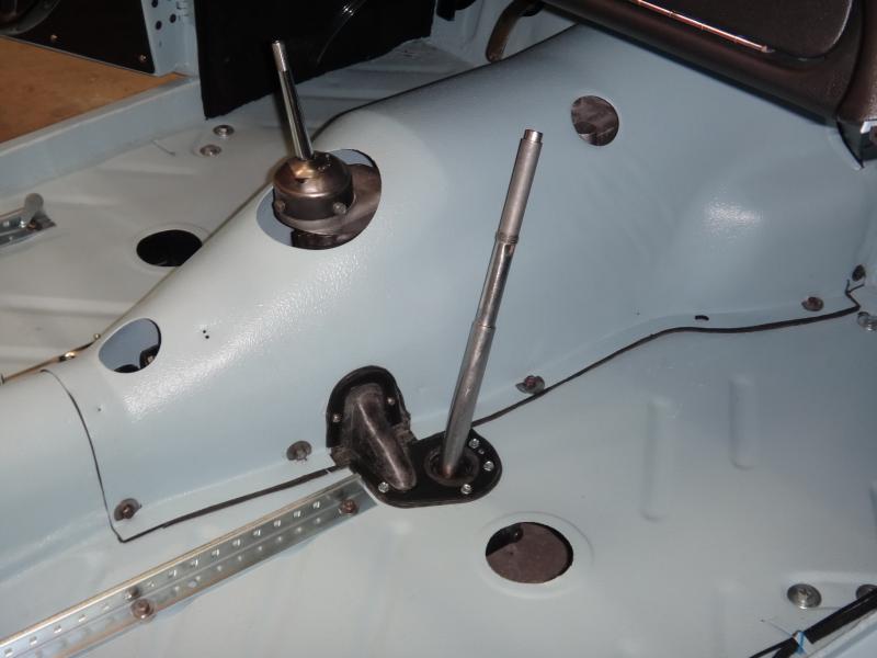

Here are a couple of photos of the boot and mounting plates...
Rick...
Thanks Rick, the pictures help a bunch!
Dick
