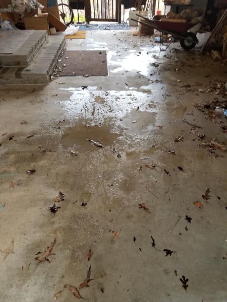

One of the problems we have in Georgia is the changes in temperature and humidity in Spring and Fall. It gets cold then warms up with an increase in humidity and you get this. Our breezeway and the water is condensation. It forms on any cold objects like my TR3 even though it is in the garage on all exposed surfaces also on tools etc. Have to put a heater in the garage?

Hi David. Same thing happens here in Connecticut in spring. Outdoor things are *cold*, but warmer humid air moving in sets up the condensation.
Only thing you can do is prevent the warm humid air from entering the area, closing it off with walls - altho' setting up some big fans can help a bit.
I had the same problem with the shed I kept my TR3 in. Replaced the shed with a real garage, and the problem disappeared.
Tom M.
Store car on old plywood, it will absorb the water rather than getting on car. Cardboard is fine as well. Stand it up outside in sun once in a while to dry out.
Hard to tell from the pic but could that be moisture from the concrete floor that is condensing do to temp changes?

Whatever you do, you need some serious ventilation through that area. Tom alluded to that above. Getting that stagnant air out of there will do wonders.

Elliot, my slab water spots all over the place.
Water table about at 1-2 foot below grade.
Know for a fact they didn't plan on that when the slab was poured.
I can tell that by all the other shoddy building practices

So I'm assuming you don't have a basement.
It's the cool slab condensing the moisture in the air... just like the outside of your ice tee glass on a humid day.
In my "other life" I was a sales engineer (fancy title!) at a commercial/industrial heating and ventilation manufacturers' rep agency. This was in Louisiana, a state with significant humidity levels, and several of my clients were poultry processing plants. They use a LOT of steam, and have tremendous issues with humidity control. One of the first rules we were taught was the need to move and exchange air to control humidity.

The area in the photo is the breezeway open on both sides so the air moves through freely. The window in the garage door was covered in moisture as were both cars in the closed garage.
The grade level is actually built up from nothing at the camera location to about 5 or 6' at the end of the breezeway.
