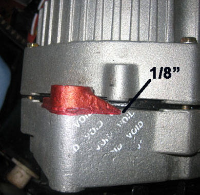

That's cool-, I fine with designing steel shapes. The
new top mounting bolt arm piece came out ever so nice.
The problem is the bottom bolt hole stubbie. The entire
alternator is well over 1/2" out of true with the other
two pulleys or flywheels, whatever they are.
Can I shave off the excess steel with my bench grinder and
flat file? Or do I need to take the new alternator to a
machine shop and have it milled ever so smooth and accurate?
Photo attached for viewing.

To claify photo- I need to remove all the
steel highlighted in red marker pen including
about 1/8" down into the housing itself.

The alternator that you bought is either a GM 10SI or 12SI. Both are excellent alternators, and wire up the same. If you are using a Dan Master's wiring harness, there will be no problem wiring up the GM alternator. As a matter of fact, the wiring diagram in his instruction manual shows a GM alternator. /ubbthreads/images/graemlins/thirsty.gif
Edit: I see that you are worried about the grinding of the drive end on the alternator. Get past that!! Grind away and use the file and you will be fine. That GM unit has it all over the Lucas alternator. You won't regret it.

I say go ahead and work with the GM alternator. You have an idea of how to go about the modifications. The end result should be worth the effort. Plus you'll have the knowledge to share.

Well **** !! It looks like I wrecked the new alternator
before I even got it over the bench grinder to try to
get it to attach to my TR..
When I split it in half to get access to grind off the
mounting holes- 2 tiny springs popped out on the floor
and I have no idea where they fell from. Also it looks
like two little rectangles of black material attached
with very tiny braided copper wires came loose as well.
Should I throw the new GM in the trash and order an
ancient tech Lucas to go with the Dan Masters wire
harness? It does not appear I have the skills to
change out the alternator. I know zero, zip, nada
about anything electrical.
NO, you don't have to throw it in the trash. If you didn't break those two "black things" (they are the brushes) you can put it back together without a problem.
The brushes should now be dangling from a white plastic thing called the brush holder. What you have to do is get a paper clip and straighten it out. That is what you will use to hold the brushes and springs in place when you reassemble everything. Put one spring into the lower cavity (as you're looking down into the alternator back) and the push the lower brush into the same cavity with the wire oriented so it slides along the slot in the brusholder. Hold it in with your finger and from the back of the alternator push the paper clip in through the access hole back there. You'll have to push the brush down enough to get the paper clip in front of the brush. Push the paper clip in only far enough to catch the middle section of the brush holder. Now insert the second spring and brush and pusH the paper clip through the last hole in the brush holder. You now have the brushes set and can easily re-assemble the alternator when you're down grinding.
When you have the alternator re-assembled, just pull the paper clip out, and you will hear the brushes pop against the rotor slip ring. /ubbthreads/images/graemlins/cheers.gif
If anyone else ever has to do this job, if you have an air compressor, take the rotor nut off, the pulley and fan, then you can slip the drive end housing from the alternator, leaving the rotor behind, and not have to deal with the brushes popping out.
Edit: If you have trouble setting the brushes with the brush holder in the back, you can always take out the three screws holding it and the voltage regulator in. Since the diode trio is attached to one of the screws, just go ahead and remove the three nuts and take out the stator and trio. The only thing you have to watch is the insulators on the three screws that you take out when you remove the brush holder. IIRC, one of them is NON-INSULATED, so make a notation of where that one goes.
But, you should be able to set the brushes without removing everything.
