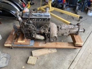

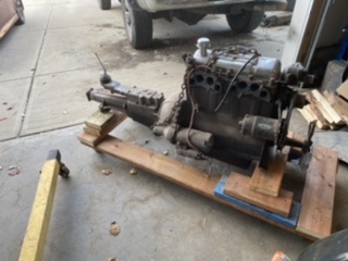

Well the engine is out of the truck and into a rolling stand 6DEE89B1-DD7E-4DFD-B137-30B2D2BDAA6C.jpeg
so I sprayed lps 1 rotated the engine and then filled it up with mouse milk, and acf-50, and sprayed down the top end with the same (valve cover removed) and left on #1 TDC. just need to find some covers for the opening and a “blanket” and it should be good to sit for awhile. I need to find a good home in the garage for it, so I guess it’s clean up time.
