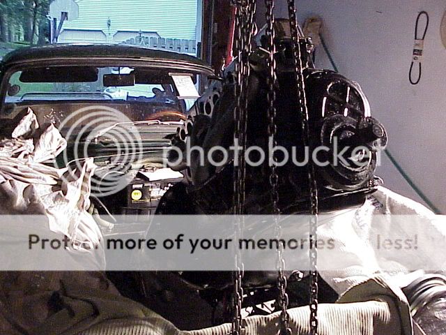

Greg: maybe 10 years ago, I blew the head gasket on the TR250. I decided to pull the engine and have it rebuilt. I had very good success removing and replacing the engine-transmission combination. It's not hard at all - just take it slow and you need to use a "load tilter" (don't know the correct terminology. Here's a couple of pics.
