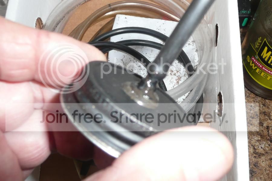

I prefer the usual method with the wife working the pedals but have had a couple of situations where pressure bleeding was needed. I made my own by finding caps that fit the reservoir and adding an air connection to them.
This set-up applies air pressure to the fluid in the reservoir rather than pumping fluid. Parts should be clean but don't have to be brake fluid safe (I used a barbed fitting and hose for 1/4" irrigation line). Air pressure is kept low (about 18#) using a small HF air tank. Probably lots of ways to do this, I just cobbled it together from what I had on hand and it worked a treat.
The cap I made that fits the TR3 reservoir:
that looks something I could do. The TR6 has a plastic reservoir. How much pressure will it stand?
I'd keep the pressure low (maybe 12# or so) -- I would be more concerned about the hose from the reservoir to the M/C popping off rather than the plastic bottle itself (I have no idea how they are connected on a TR6, maybe it isn't a hole but just a rubber fitting?).
Doesn't take much pressure to do the job.
Less than #10, and I highly recommend an EeziBleed (Gunnison).
