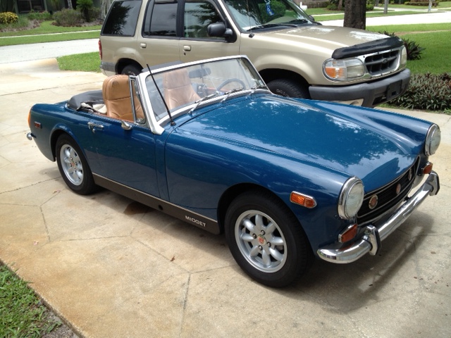

I just had 4 Minilites powdercoated. The guy I used does nothing but wheels. He soakes them for 24 hrs. in power steering fluid to remove all paint, grime etc. He also checks them for roundness. His mounting machine never touches the front of the wheel.
Cost, stripped, coated, mounting and balancing, is closer to $135/ea, but the result was worth it.New Wheels.JPG

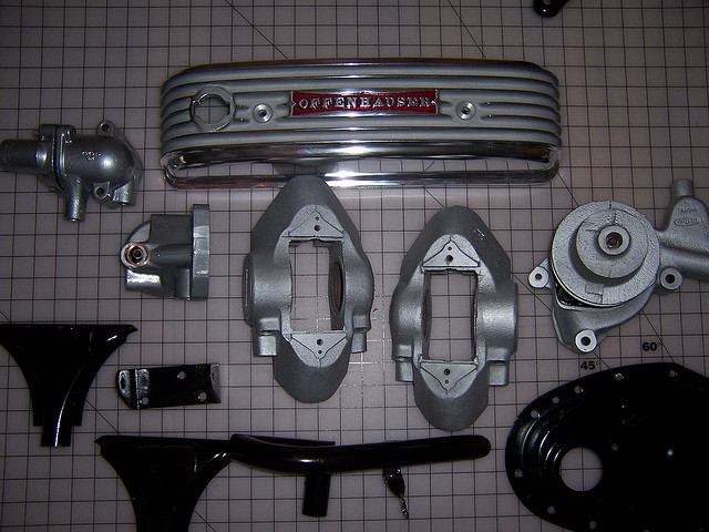

Everything in this photo was powder coated by myself in a small oven (sorry it is all TR stuff :devilgrin:) using a HF powder coat system and Eastwood powder coat. It is easier than paint, no primer and dry when cooled out of the oven. Prep is the most important part of the job. 4242136200_c2a3b5369a_z.jpg
Prep is the key!!

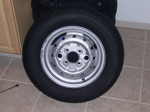

I had done some experimental painting on them before with mixed results, now I know how/what I want to do. I used a few iterations of paint remover and pressure washing to get most of the paint off, then finished with a wire wheel. Here’s one that is ready for paint:
