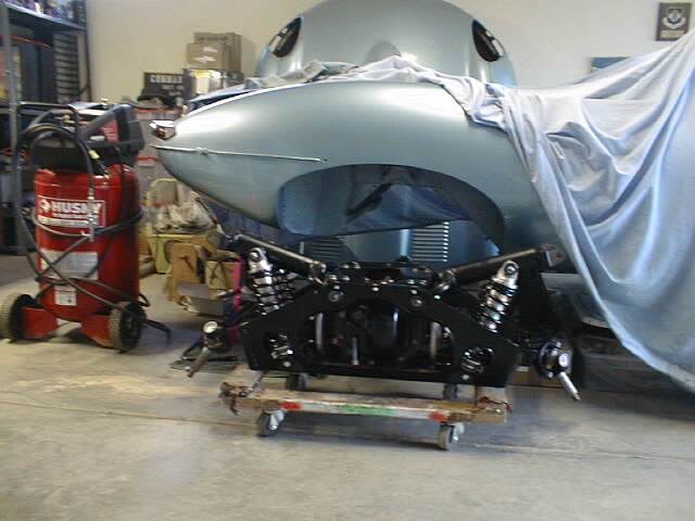

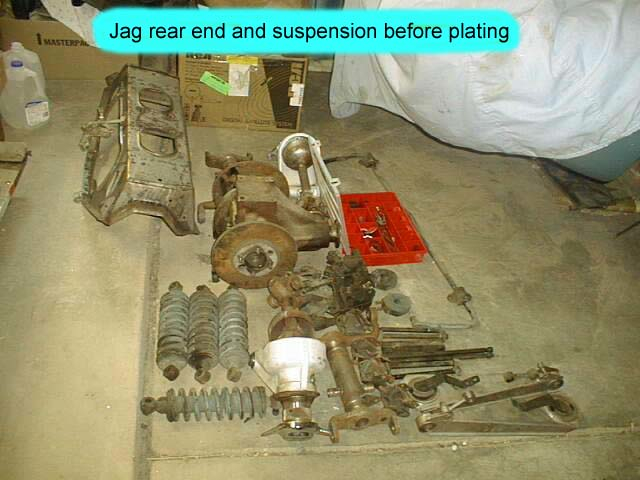

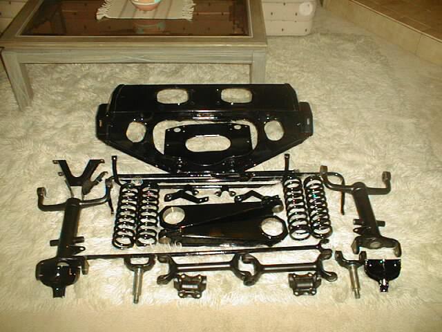

I'm no expert but I don't think you're supposed coat the threads - at least they didn't when I had the rear suspension on my E-Type powder coated I had no problems putting my IRS together after powder coating.

You're not supposed to coat holes that other parts go through, nor threaded holes - as stated twice in this thread. The member o1marc said as much (and he does powder coating for a living it seems). I had my Jag rear suspension coated (see pics above) and knew enough to discuss with the place not to coat certain holes that were threaded, or where I knew close-tolorance fittings had to go (like bushing holes). Any competent powder coating shop should know this I'd think.
