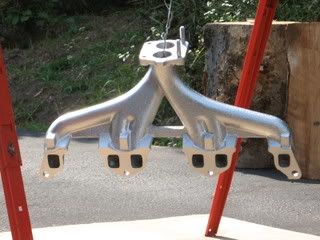

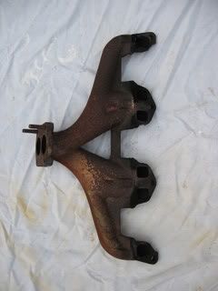

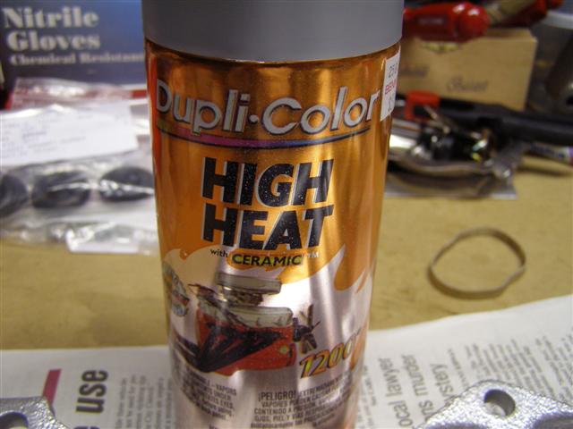

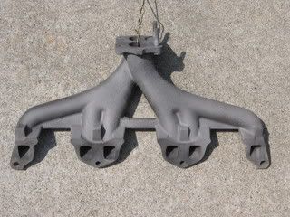

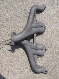

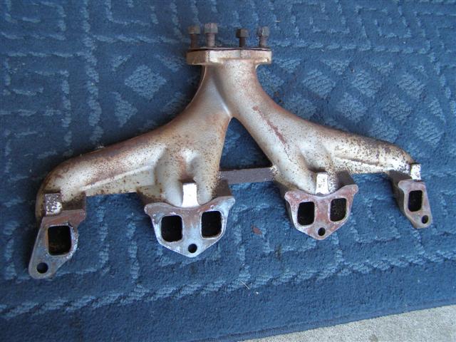

As you can tell from my web site, I like Dupli-Color 1200 Degree Ceramic paint. I was bored this past weekend and did my original exhaust manifold so I can wrap it up and put it away.
The red paint has held up fabulously on my block.
EDIT: I forgot to state that this rusty manifold was grit blasted and acetone washed before painting the silver.

According to Dupli-Color, now you need to bake it for 30 minutes @300F. It should smoke and smell like plastic as the resins burn off and the ceramic sets.
Peter,
I never did any of that except to run the engine after painting. Oh well, I got lucky!! However, per the instruction, I painted in several layers and I DID wait for the seven (7) days for the paint to cure. The block was perfectly clean and washed down with acetone prior to painting.
But it really did smell like burning plastic though when we were running the 20 minute break in cycle.
I really don't think that I'm going to tell my wife that I need to use the oven for a few hours to cure the manifold. The next owner can handle that process.

I bought mine at an Auto Zone. About $5.00 per can. I'd put the three coats on per the directions, let it sit all day in the sun exposing each side for several hours and install it a day or so later. You'll be able to tell by touch if it's ready to be handled and the sun will speed the drying up a lot.

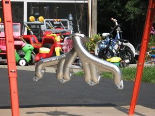

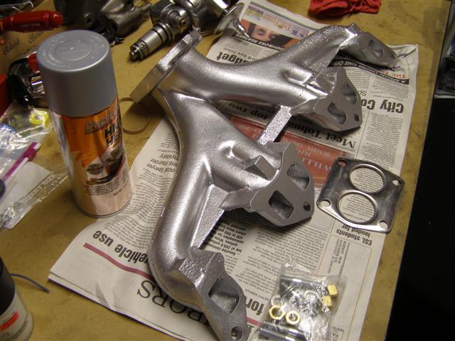

got out of work early, picked up manifold, Dupli-Color, acetone and went to work. I put an old windex pump sprayer into the acetone container and hit the manifold up pretty hard (the stuff evaporates quick). Let it dry for a while and started painting per the directions (3 coats about ten min apart).
The longer you let it sit in the hot sun, the harder the paint becomes as it cures. Nice job!! One or two days and you should be good to go.
Note: The key as always, is moderate layers, but applied in the time frame and then just let it sit and cure.
The machine shop had to acid dip my original Dupli-Color painted head twice to get the paint off of it, so it will last if done properly.
