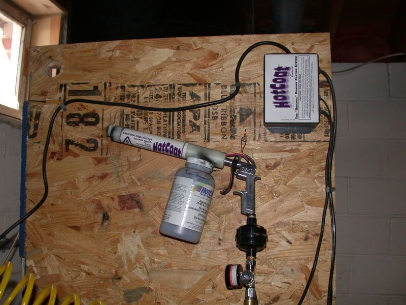

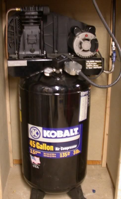

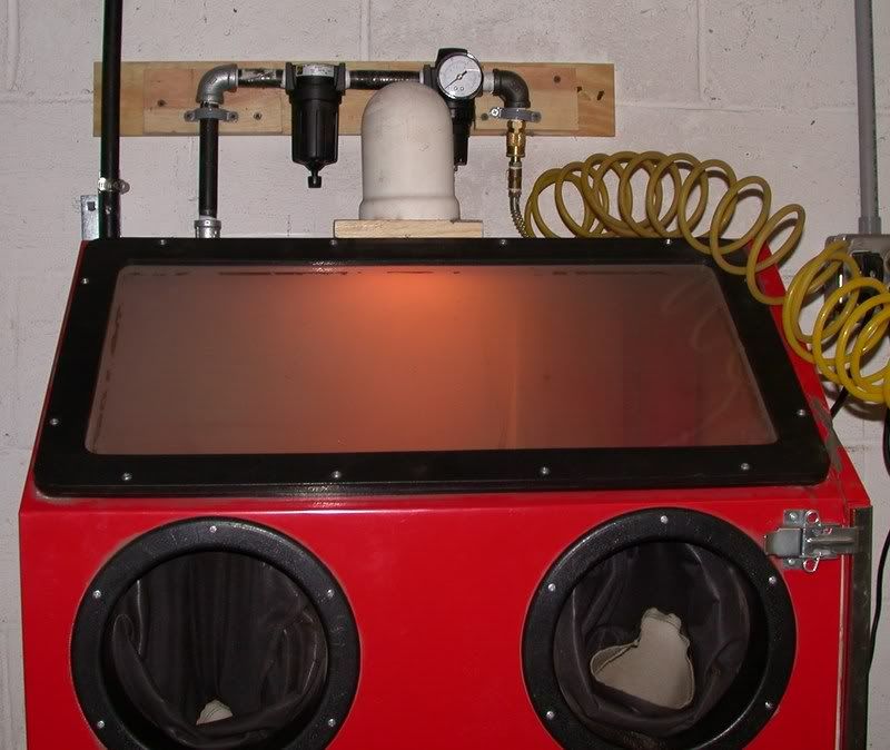

Someone recently asked about my powder coating setup. Really nothing fancy. Eastwood entry level gun and power supply and regulated dry air and our old Jenn-air range. :thumbsup:
<span style="font-weight: bold">compressor from Lowes</span>
<span style="font-weight: bold">Harbor Freight booth , regulator, drier</span>
<span style="font-weight: bold">Eastwood base unit gun and power supply</span>
